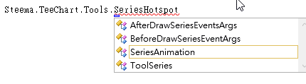

Dear Sir:
We cannot use the HotspotTool function described on the website in WebForm.
Are there any requirements to use this feature?
We have TeeChart for .NET Standard Business Edition license.
Or is there a demo code for reference?

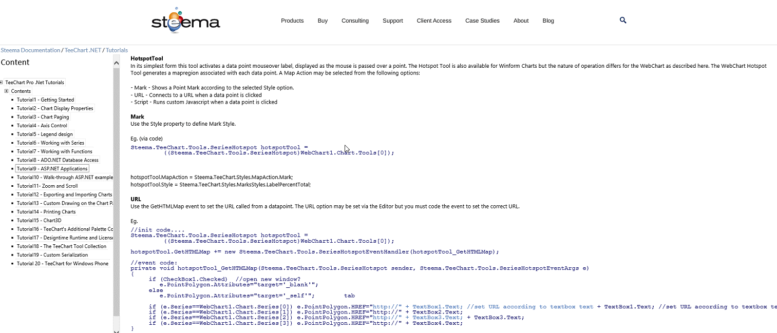

There is some demo code here:
https://github.com/Steema/TeeChart-NET- ... dDrillDown
That is a Pro project but the functionality/code is applicable to the standard version.

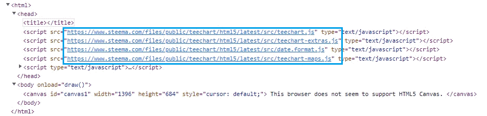

Dear Sir,
1.In the JScript page generated by using TeeChart .Net version, the JavaScript file path to the website will be automatically generated.
Because our internal network cannot connect to external web pages, can we download and use the files from the website?
(PIC-1)
2.We purchased TeeChart .Net business version contain JavaScript. Can we use the JS files on the website?

Re: TeeChart HotspotTool Function
1. Yes, you may download and source the teechart javascript pages locally. Use the "Export.Image.JScript.SourceScriptPath" property to modify the location looked for by TeeChart.
2. Yes.

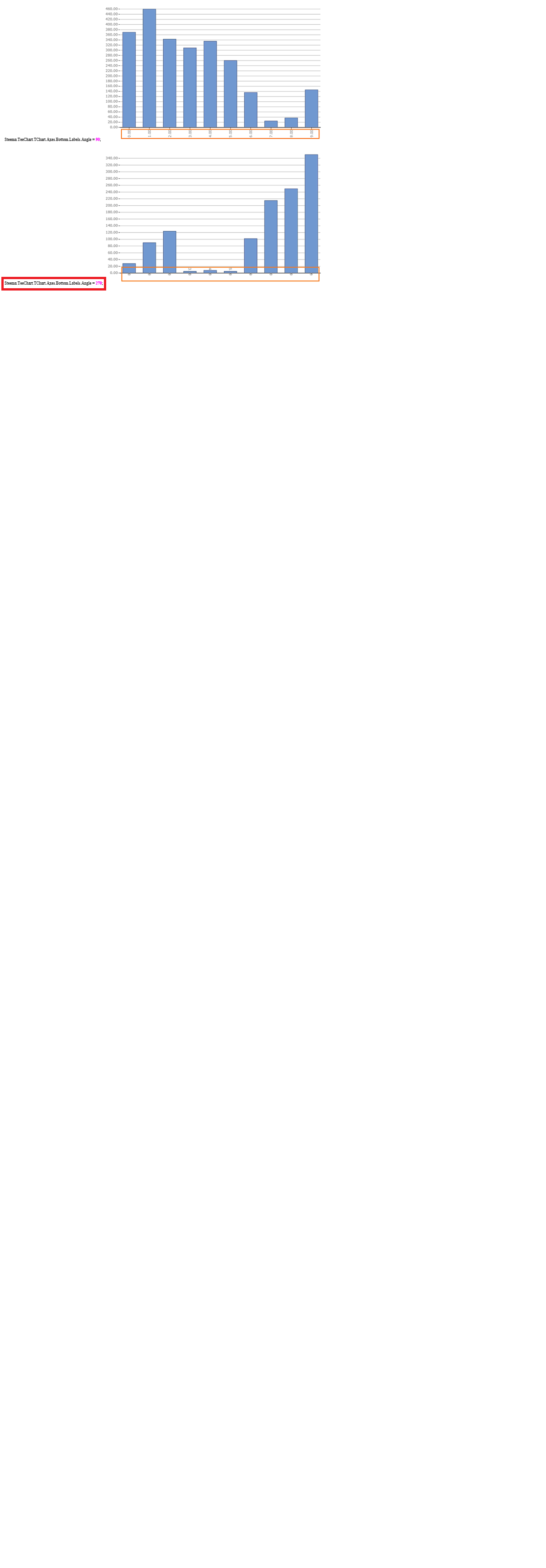

When using JScript, the X label is normal when the angle is 90, but the angle setting 270 will error.
Please advise.
I believe this has been resolved in the latest code. I'll check that is the case and when the fix is to be published and get back to this thread.
The public version of TeeChart for Javascript now includes a modification to help resolve the incorrect plot of 270º aligned axis labels.
