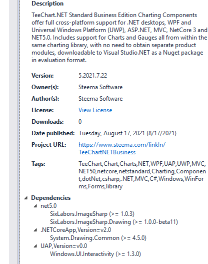

I keep failing to install TChart.
The attached screenshot is from the NuGet manager.
Installing ImageSharp went fine. No problems there.
The other package is a pain in the neck. There are so many dependencies, I've lost control.
Please keep in mind that we are DISCONNECTED from the Internet, so each package should be handled separately.
Am I missing something?
Is there an easier, more straightforward way of installing this package?

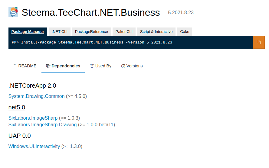

I'm sorry you're having problems. On this page we have the dependencies for Steema.TeeChart.NET.Business 5.2021.8.23:
Screenshot from 2021-10-08 09-50-48.png (65.42 KiB) Viewed 52001 times

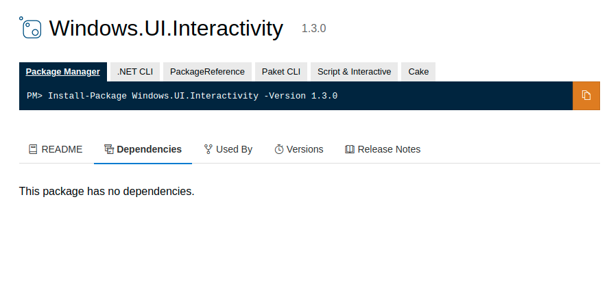

And here we have the dependencies for the only package that isn't ImageSharp, Windows.UI.Interactivity 1.3.0:
Screenshot from 2021-10-08 09-50-59.png (38.1 KiB) Viewed 52001 times
I'm not sure therefore which dependencies you're having problems with.
Please bear in mind that if you don't want to use the UWP assembly you do not need Windows.UI.Interactivity: you can unzip the NuGet package and reference the assembly you wish in your project (only the Server assembly has the ImageSharp dependency, the WinForm and WPF have none).
