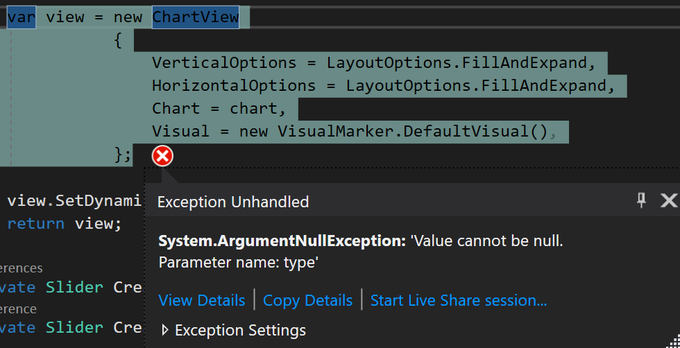

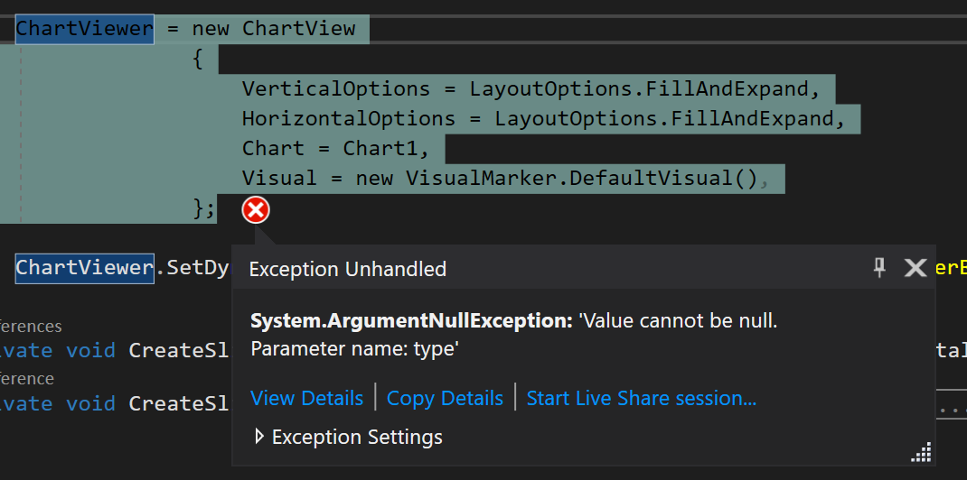

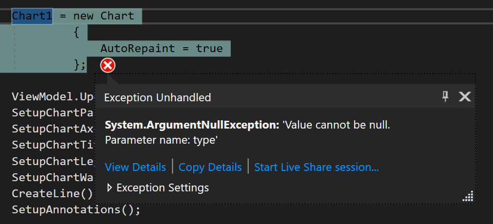

With Xamarin.Forms Version 5.0.0.1874, Version 4.8.0.1821, Version 4.8.0.1687 and Version 4.8.0.1560, graphs break on both Android and iOS. it displays if you catch the exceptions but does not render correctly: popup annotations are broken and don't show, pinch and zoom is gone, etc.
I have not tested versions prior to Version 4.8.0.1560.

Also, the previous exceptions still over on page creation.
