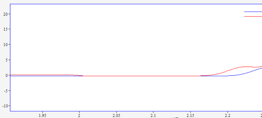

I added a blue line and a red line to the chart. When the points of the two lines are the same, the red line will cover the blue line. How can I make the blue line display to the top layer without changing the order of addition. Is there a z-index like attribute?

The Series class has a ZOrder property, but this only works when the Chart is in 3D mode. This means that the only way to achieve this, as things stand, is to swap the order of the Series in the Series collection, as in the following example:
