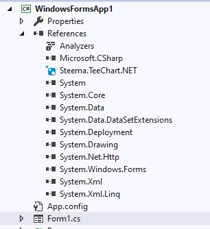

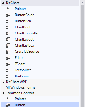

Again, this functionality works as expected here:
