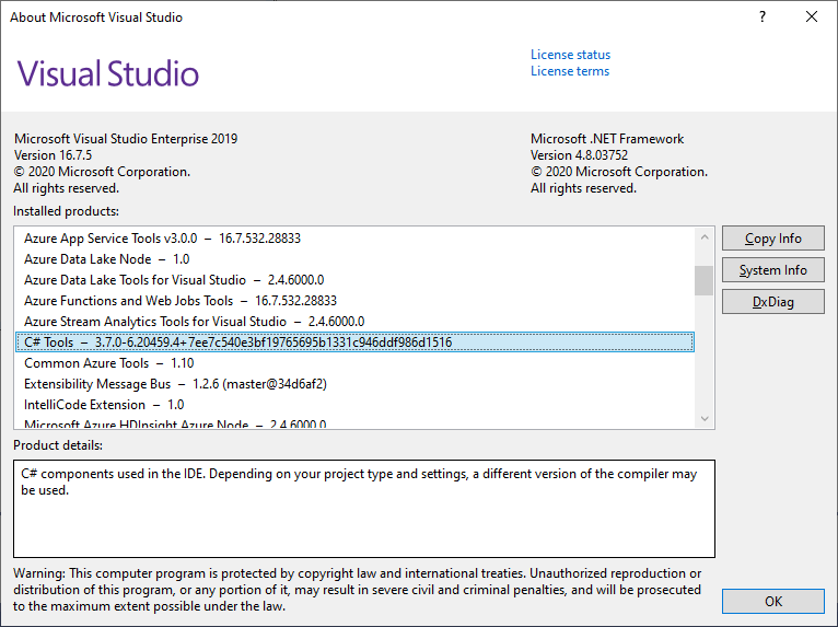

my experience is a little different to yours. I'm using the following version of Visual Studio:

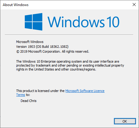

running on the following version of Windows:

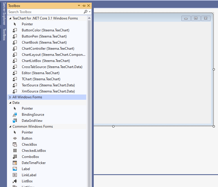

When I add the latest version of Steema.TeeChart.NETCore.WinForm (v4.2020.9.16) to a project via NuGet, Visual Studio automatically shows me the Controls in the ToolBox:

I have the same VS version
but my OS is Windows 10 x64 2004

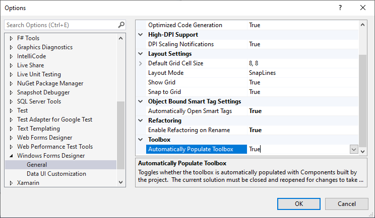

My VS settings in Preview Features block:

from this link here, I discovered that the setting that makes this work for me is this one:
Here's a minute-long gif that shows this working on my machine:

Automatically Populate Toolbox is already set to true (and it successfully working for WinForms .NET Framework application and Steema.TeeChart.Pro nuget).
I'm going the same way that your gif shows - but no new components are added to VS Toolbox after readme.txt is shown.
BTW. On my Toolbox has only 2 groups of same 20 controls - All Windows Forms (.NET Core) and Common Windows Forms (.NET Core)(General group has 0 controls).

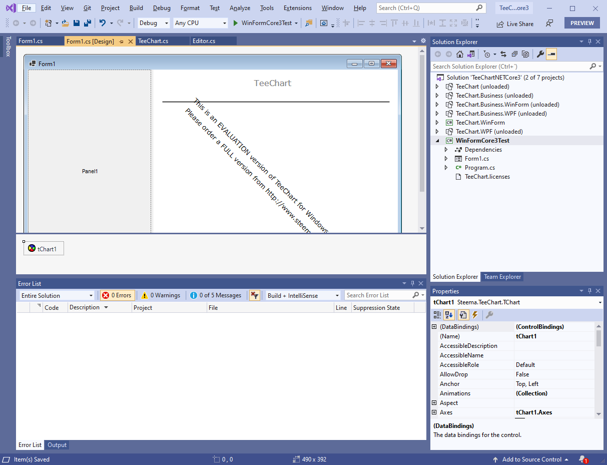

Hello again. I've uninstalled and installed again VS 2019 16.7.6 and now my toolbox have as many groups and contols as yours.
Adding Steema.TeeChart.NetCore.WinForms nuget populates all controls as your gif shows.
But when I place TChart control on my form and right click it - menu lacks all TeeChart menu items:
Same menu in .NET Framework looks like:
Why you TChart control (.NET Core) doesn't have feature parity with TChart control (.NET Framework)? Or maybe I'm missing something?

In fact it is not TChart that does not have parity, it is the Windows Forms Designer - as you can read here, the Windows Forms Designer is a work in progress in .NET Core, whereas of course in .NET Framework the work is finished. Note that in that blog post it mentions that support for third-party components is 'work coming next'.
Out of interest I download the latest preview version of Visual Studio 2019 - 16.8.0 Preview 4 - and I see that the Windows Forms Designer for .NET Core still doesn't work with our third-party component as it does with .NET Framework. Note that TChart is on the form and is also put at as a non-visual component into the component tray - given that the code between the .NET Core version of TChart and the .NET Framework version is identical, this difference can only be due to the .NET Core Windows Forms Designer itself.
