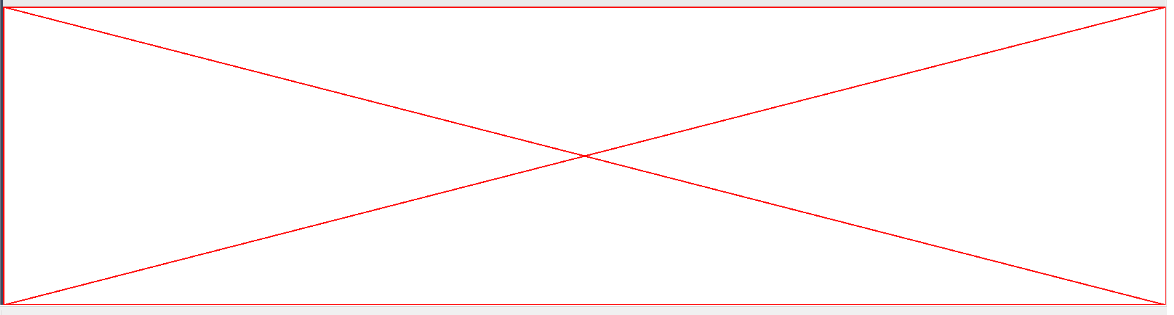

In my program, I need to dynamically add points to the line.
When I click the button, a line is created, and the method is called regularly to add points.
The line will be recreated when the button is clicked again.
The core code is as follows.
First add a line to the chart through the following code:
private void btn_Click(object sender, EventArgs e)
    tChart1.Series.Clear();
    line = new Line(tChart1.Chart)
        Title = "line1",
        VertAxis = VerticalAxis.Both,
        HorizAxis = HorizontalAxis.Both,
        Color = colorBtn.BackColor
Then call the following method to add points:
public void AddPoint(double x, double y)
    line.Add(x, y);
Occasionally the phenomenon shown in the figure below will appear. How can I prevent this from happening?

Thanks for your answer,I am also using the latest version on NuGet.
In my program, the line is created every time the button is clicked. Like the following code:
            //if(timer1.Enabled)
            //    timer1.Enabled = false;
            //    ChangeButtonTitle(true);
            //else
            //    timer1.Enabled = true;
            //    ChangeButtonTitle(false);
            AddSeries();
Of course the actual code is more complicated.
This situation does not happen every time, but only in a very small number of times.

It's not an easy Recurring problem.it did not happen in subsequent runs.May not be the problem of adding lines.
But this is a hidden danger in my code.Do you have any other suggestions for this situation?
The 'hidden danger' may be multithreading - GDI+ is not thread-safe, which is why it is not recommended in future development as you can see at the bottom of this page. Other than this, and in the absence of being able to reproduce your issue here, I'm afraid I can't think of anything else.
