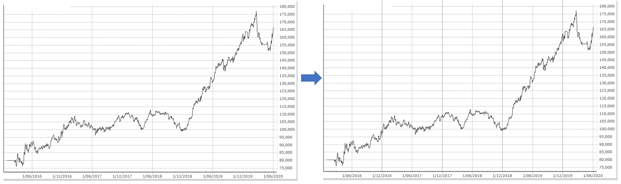

I'm pretty new to teecharts. I created a chart but for some reason the vertical line spacing is skipping one date. Basically this is what I want it to look like

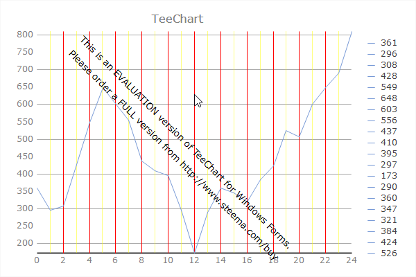

Apologies for the lateness of this reply. In TeeChart we have a Grid and a MinorGrid for each axis - so code such as this:
            var line = new Line(_tChart.Chart);
            line.FillSampleValues();
            var bottom = _tChart.Axes.Bottom;
            bottom.Grid.DrawEvery = 1;
            bottom.Grid.Color = Color.Red;
            bottom.Grid.Visible = true;
            bottom.MinorGrid.Color = Color.Yellow;
            bottom.MinorGrid.Style = System.Drawing.Drawing2D.DashStyle.Dot;
            bottom.MinorTickCount = 1;
            bottom.MinorGrid.Visible = true;
Will give us:

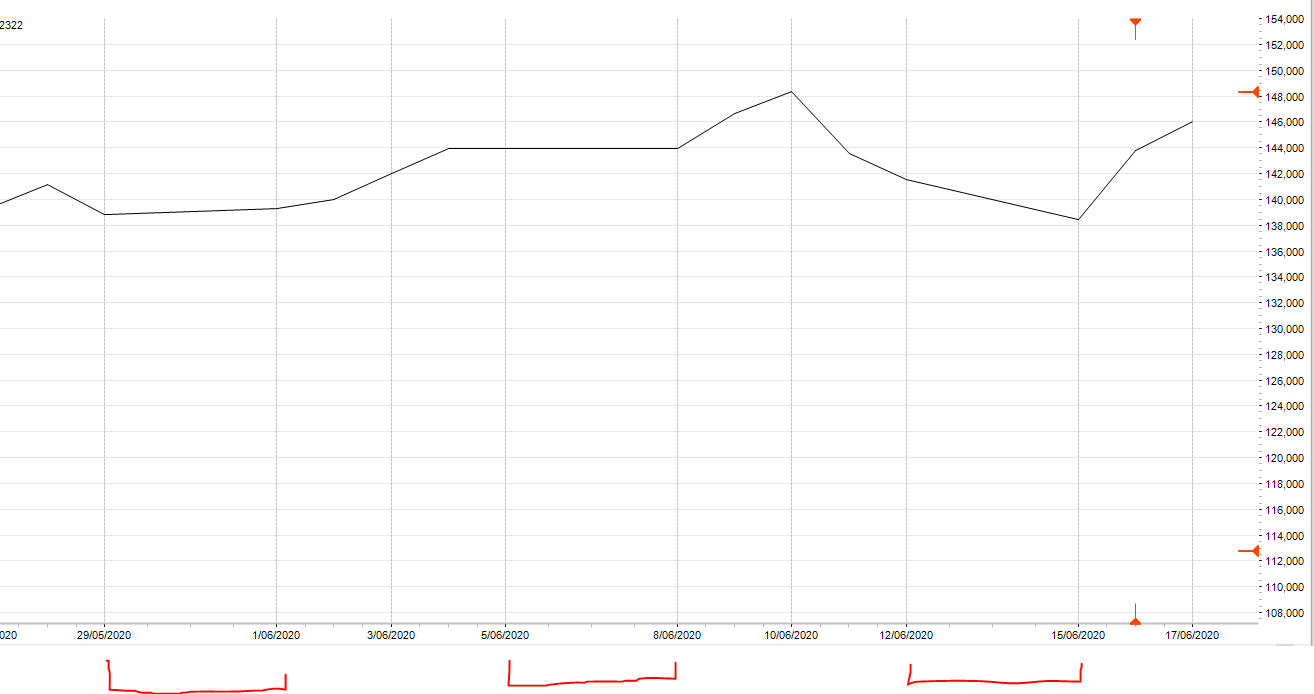

Thank you for responding. I tried to enable the minorgrid
but this is what I got, if you notice, the vertical line I want is still missing (red arrow)

What happens when you add in all the code that refers to Grid and MinorGrid on the bottom axis? DrawEvery is set to 2 by default; maybe it's 1 that you need.

Thank you Christopher, drawevery = 1 solved my problem! :)

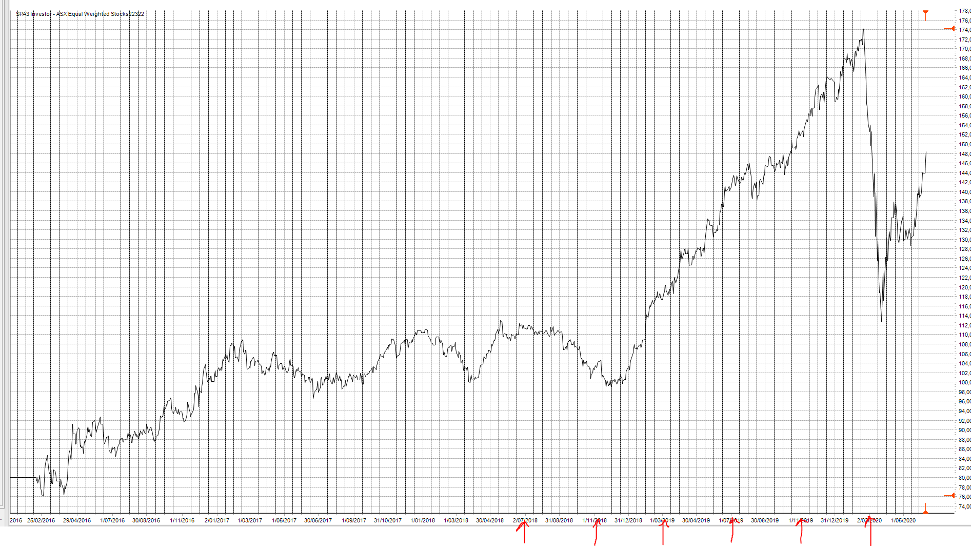

Another thing related to vertical lines. When I zoom in I got this non equal spacing axis lines (see red lines which are bigger), How do I make sure these has the same spacing.
How are you adding values into your series?

This is how I add values to my series
	//Clear the series
            _view.Chart.Series.Clear();
            //add new series
            Steema.TeeChart.Styles.Line chartLine = new Steema.TeeChart.Styles.Line(_view.Chart.Chart);
            _view.Chart.Axes.Custom.Add(new Steema.TeeChart.Axis(_view.Chart.Chart));
            _view.Chart[0].CustomVertAxis = _view.Chart.Axes.Custom[0];
            chartLine.VertAxis = Steema.TeeChart.Styles.VerticalAxis.Right;
            chartLine.GetSeriesMark += ChartLine_GetSeriesMark;
            Dictionary<int, dynamic> tagData = new Dictionary<int, dynamic>();
            tagData.Add(0, _view.SelectedPortfolio.PortfolioName);
            chartLine.Tag = tagData;
            chartLine.LinePen.Color = Color.Black;
            chartLine.LinePen.Width = 1;
            chartLine.Brush.Color = Color.Black;
            for (int i = 0; i < data.Count - 1; i++)
                chartLine.Add(data[i].EventDate.Date, Convert.ToDouble(data[i].Portfolio_Value_A));
            _view.Chart.Axes.Right.Automatic = false;
            //add 15% space above and below
            double adjustmentForSpacing = Convert.ToDouble(data.Min(d=>d.Portfolio_Value_A)) * 0.05;
            _view.Chart.Axes.Right.Minimum = Convert.ToDouble(data.Min(d=>d.Portfolio_Value_A)) - adjustmentForSpacing;
            _view.Chart.Axes.Right.Maximum = Convert.ToDouble(data.Max(d => d.Portfolio_Value_A)) + adjustmentForSpacing;
            _view.Chart.Axes.Right.MaximumOffset = 0;
            _view.Chart.Axes.Right.Labels.Font = GlobalFont;
            _view.Chart.Axes.Right.Ticks.Color = Color.Black;
            _view.Chart.Axes.Right.Ticks.Width = 1;
            _view.Chart.Axes.Right.Ticks.Length = 2;
            _view.Chart.Axes.Bottom.Labels.Style = AxisLabelStyle.PointValue;
            _view.Chart.Axes.Bottom.Labels.Font = GlobalFont;
            _view.Chart.Axes.Bottom.Ticks.Width = 1;
            _view.Chart.Axes.Bottom.Ticks.Length = 2;
            _view.Chart.Axes.Bottom.Ticks.Color = Color.Black;
            _view.Chart.Zoom.Direction = Steema.TeeChart.ZoomDirections.Horizontal;
Re: How to set the vertical line spacing
Post by Christopher » Fri Jun 19, 2020 9:05 am
Hello!
still not sure about this one - maybe it's the values in your data[] object, becuase when I use code such as this:
