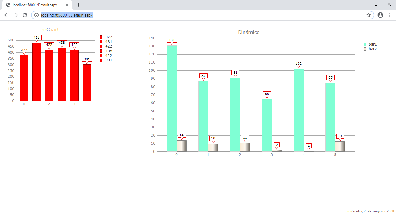

Hi, i was using version 4.2019.10.2 with no problems, until now that update to 4.2020.5.12 through nuget package manager.
Before update

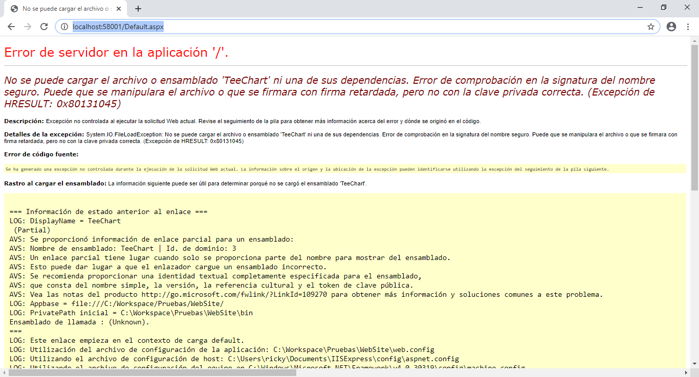

After update to 4.2020.5.12:
What can be the reason?
Thank you

If I install any verson <= 4.2020.4.6 there is no problem, it's only with version 4.2020.5.12 when the error occurs.

Hello Hermes,
apologies for this issue - we have been able to reproduce it here and will upload a rebuild to NuGet in the near future.

Post by Christopher » Wed May 27, 2020 9:31 am
Just to let you know that a new version is available here:
https://www.nuget.org/packages/Steema.T ... .2020.5.25
which resolves this issue.
