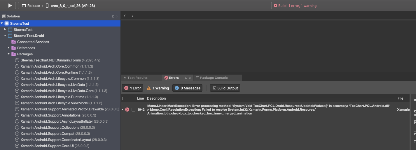

Post by Bank Van Breda » Tue Apr 14, 2020 12:47 pm
Still not working with new nuget.
Do we need to config something on our end?
Screen Shot 2020-04-14 at 14.45.53.png (143.94 KiB) Viewed 21736 times

Post by Pep » Tue Apr 14, 2020 4:00 pm
I cannot reproduce the problem here. In order to take a look and try to find a solution, would you be so kind to attach a simple example in a new reply or send me directly to my email pep@steema.com ?
