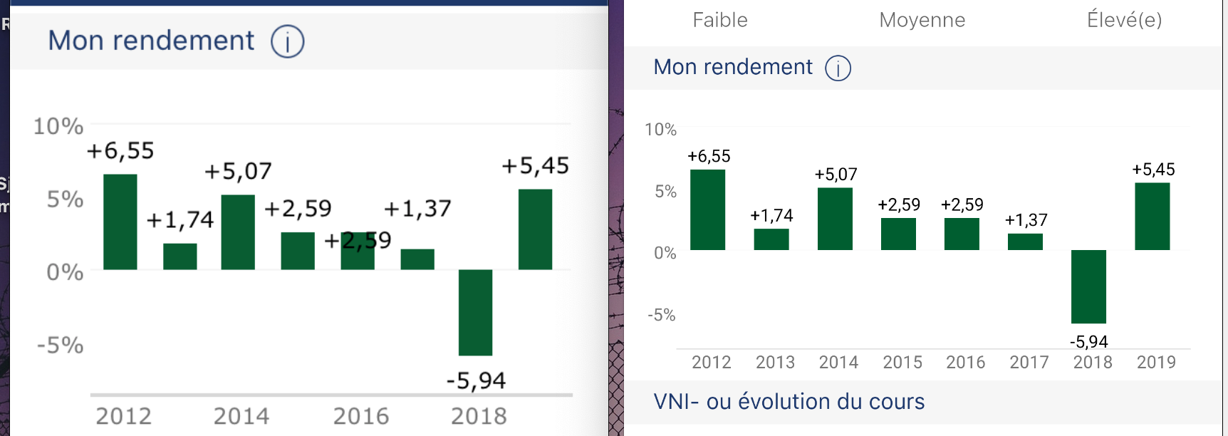

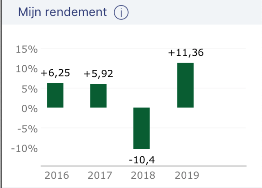

Currently our bar chart in the app looks like this:
Screen Shot 2019-11-06 at 10.45.49.png (249.26 KiB) Viewed 31949 times
So we want to allow more bars on the graph and are looking to allow the panning option.
But when I set this option, the user can keep on panning left and right so that the actual graph moves completely out of view... example:
Screen Shot 2019-11-06 at 10.53.56.png (77.68 KiB) Viewed 31949 times
So my question, how can I allow panning, but only so that the panning stops at the first left bar and last right bar?

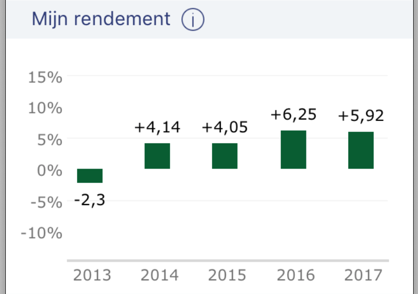

So if we look at a filled in chart with only 4 bars we set Chart.Axes.Bottom.Automatic = true. This gives us following result:
In other words the chart will put min and max value at the left and right edges of the graph and the bars will be evenly divided.

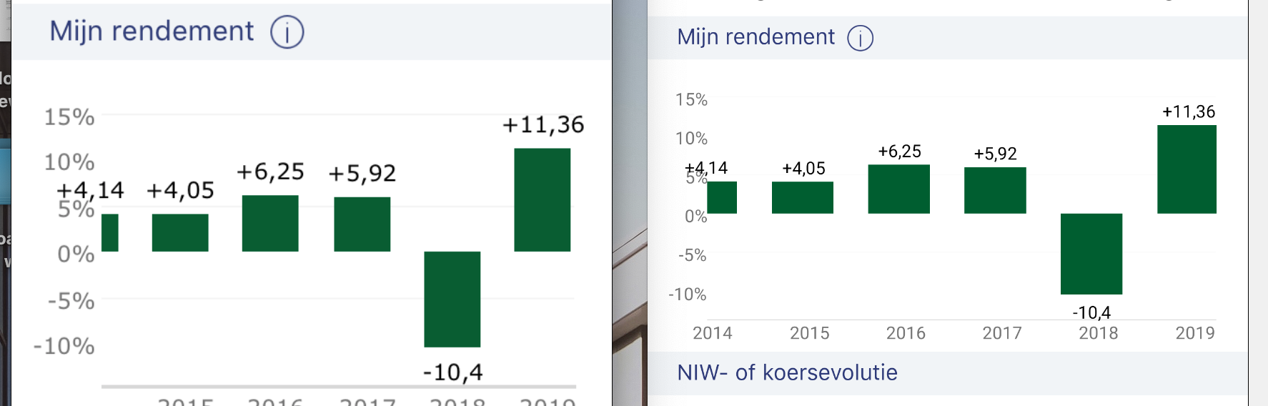

But when we have more than 4 bars, we set Chart.Axes.Bottom.Automatic = false and I now also put Chart.Axes.Bottom.SetMinMax(serie.Data.Count - 4, serie.Data.Count). This gives us:
Now first preview will position the graph correctly to only show 4 bars ( because I tweak this with SetMinMax ), but they are not evenly divided and we still see right white space.
Any way to still fix this? So that we have the same look and feel like as if we only have 4 bars... but still allow panning ofcourse?

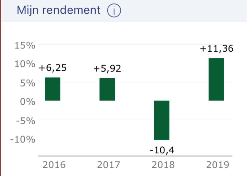

So the amount is perfect, but the bars are still smaller than the automatic generated ones...
Screen Shot 2019-11-08 at 15.43.30.png (79.04 KiB) Viewed 31903 times
Our code does have bar.BarWidthPercent = 60; but this is always set. So even if we have automatic bottom axes true or false.
Setting a number of points per page should solve it. Could you please adding :
tChart1.Chart.Page.MaxPointsPerPage = 4;

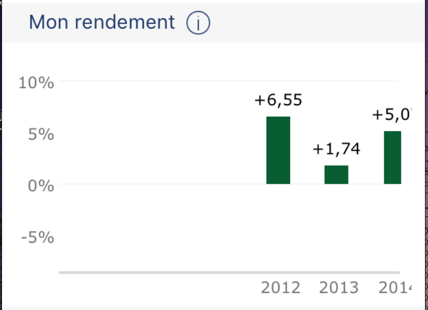

Hmm seems there is still 1 problem.
When panning is enabled, the values above the bars are shown out of bound of the graph.
Example attachment, the 4 is shown outside the graph on the left side although the bar itself stops at the left border.

you should be able to change the way that Series marks are displayed outside the Chart rect bounds by setting Clip to true for Series Marks :
bar1.Marks.Clip = true;
