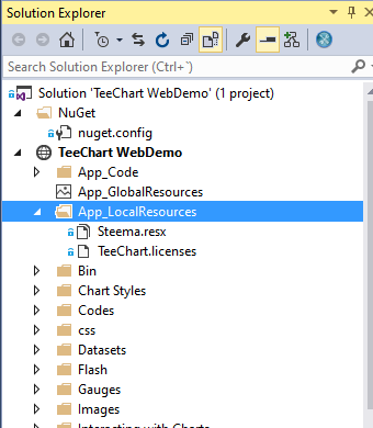

yes, this should be better documented, we're sorry. To see the TeeChart.licenses file working for a web site, you can clone the WebDemo GitHub repo from here - when you open the solution in visual studio you should see the following:
if you replace the contents of the fake TeeChart.licenses with the contents of a real TeeChart.licenses and rebuild you should see the watermark disappear. This is the required structure - a resx file named Steema.resx with the TeeChart.licenses file embedded in it.

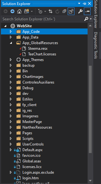

Post by Hermes » Mon Sep 30, 2019 2:20 pm

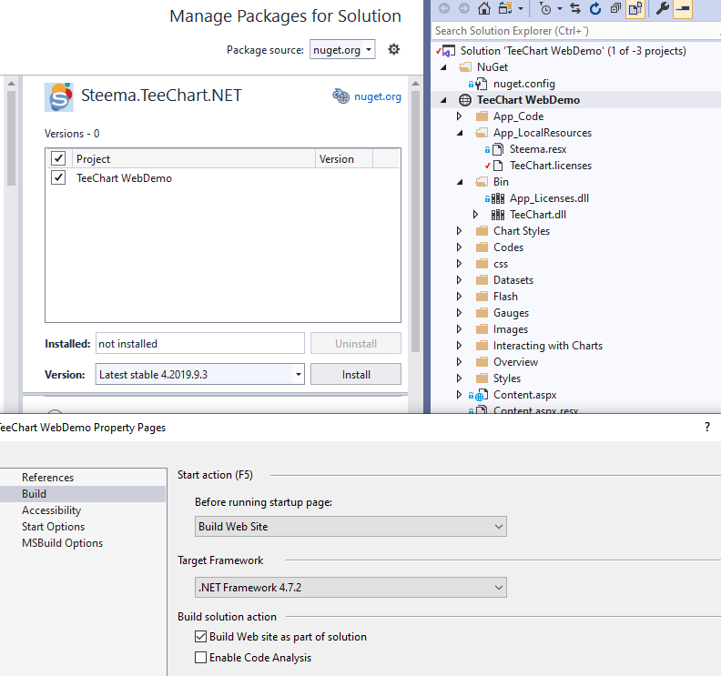

I've done exactly what you ask, except that changed the target .NET Framework to 4.7.2 and it doesn't work as expected:

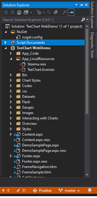

Here the project explorer:
As I've commented before, in projects type WebApplication an Windows forms, I solved the watermark problem with the same TeeChart.Licences.

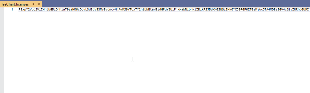

Along with a valid TeeChart.licenses file:

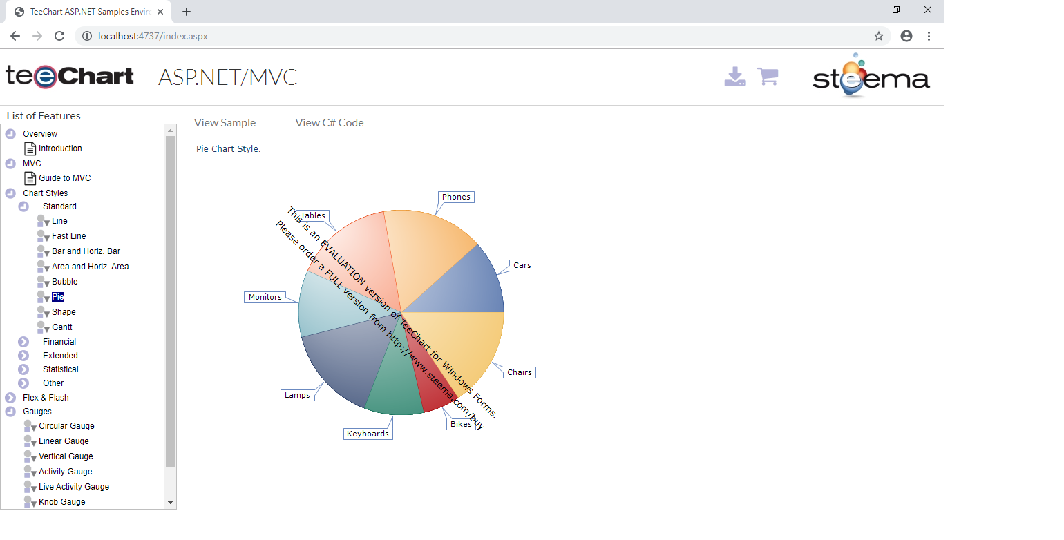

And I obtain the following result:

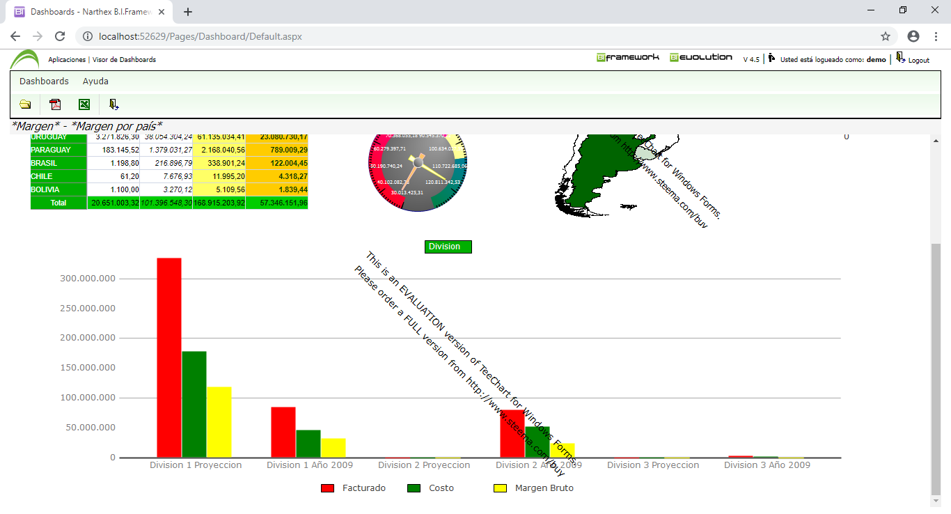

Hi, what I'm experiencing in the demo is:
If I unistall teechart, install it again (via nuget) and runs the app, it works and shows charts without watermark, but only the first time. And when Visual Studio is closed and reopen, the watermark appears again.
More, if I delete TeeChart.licenses from Steema.resx, and add it again, the same result, when the app run, the watermark is not showed, but once closed and reopened Visual Studio, the watermark appears again.

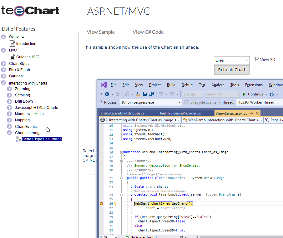

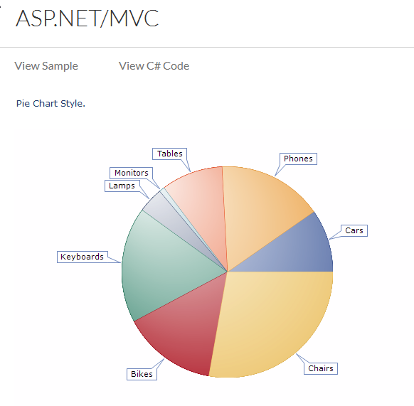

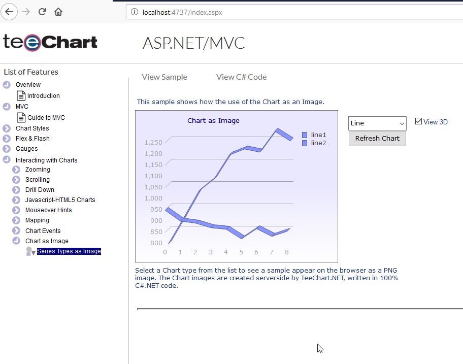

There's a page in the TeeChart WebDemo that creates a chart dynamically at runtime:
This page and chart appears without a watermark using the latest NuGet version:

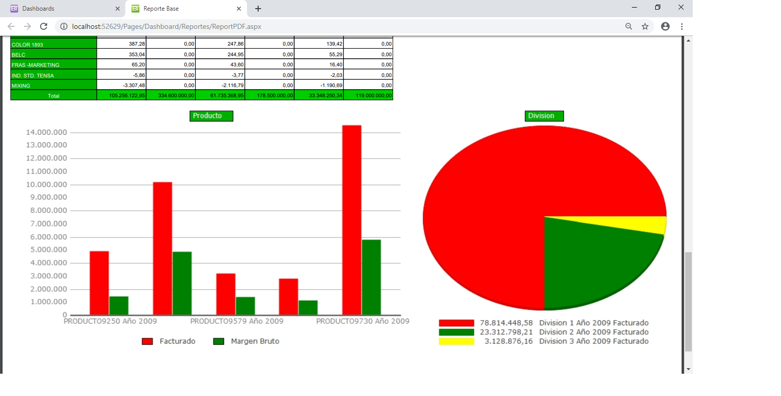

In a windows service the teechart is created and serialized, via WCF comes to WebSite where is deserialized in a new webchart. I've know the windows service got the license because it generates pdfs without watermark.
In the website, no matter the license files are present or not, the chart is shown the same way (with watermark)......
