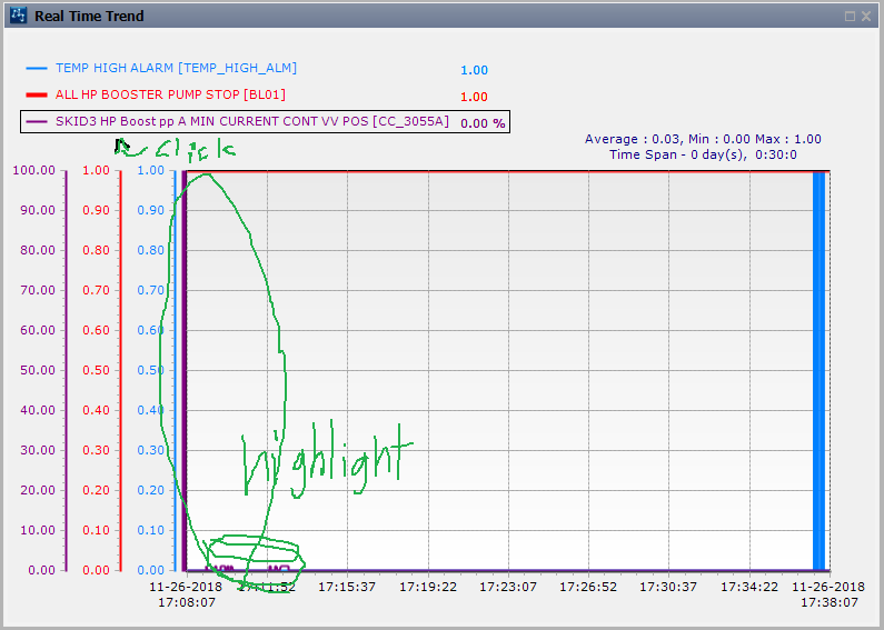

Hola
Please explain how to highlight the one line among More than one series.
Is there an option like when I clicked a item in legend, the others become blurred at tee chart?
Thank you for tee-chart

one option would be to highlight the series clicked in the legend by making the other series more transparent, e.g.
			for (int i = 0; i < 4; i++)
			tChart1.ClickLegend += TChart1_ClickLegend;
		private void TChart1_ClickLegend(object sender, MouseEventArgs e)
			int index = tChart1.Legend.Clicked(e.X, e.Y);
			if(index > -1)
				for (int i = 0; i < tChart1.Series.Count; i++)
					tChart1[i].Transparency = 0;
					if (i != index)
						tChart1[i].Transparency = 70;
