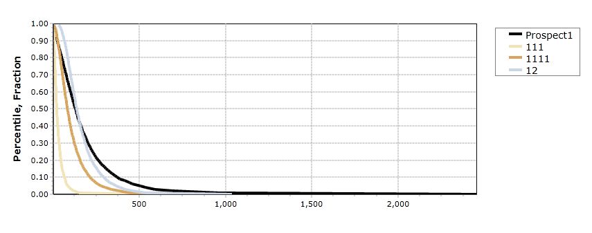

I am facing an issue in silverlight c#.
I have a plot with multiple line series but when i am clicking on its legends the line series are getting disappear.
And there is no way i found to get it back.
Please help me in this. See below snaps.
The attachment 1.png is no longer available
The attachment 2.png is no longer available
Please provide a solution.
Amol

The attachment 3.png is no longer available

Post by Christopher » Mon Aug 27, 2018 8:36 am
as always, we are going to need some code with which to reproduce this issue here. The following code works fine when clicking on the legend.
		public MainPage()
			for (int i = 0; i < 3; i++)
				tChart1.Series.Add(typeof(Steema.TeeChart.Silverlight.Styles.Line)).FillSampleValues();
			tChart1.ClickLegend += TChart1_ClickLegend;
		private void TChart1_ClickLegend(object sender, MouseEventArgs e)

Hi Team,
Thanks for the reply.
I would like to share that by this code some times application got hanged.
Can you provide a checkbox option in legends. So that by this user will check again on box to get the line back.
Amol
