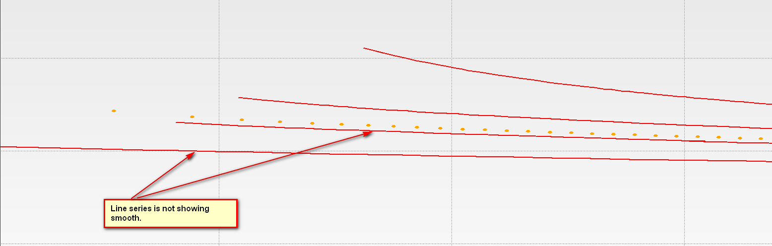

We are facing one problem that is when we draw a line series on chart the series is not looking smooth as shown in below figure:-
So kindly assist us to give the solution so we draw the line series smooth.

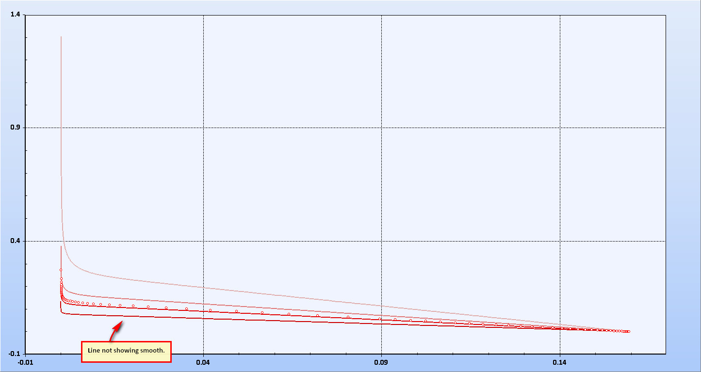

We have applied the code sent by you but we have still facing the same issue regarding the line smoothing.
For this we are sending one snap as showing below figure:-
So kindly assist us.

Post by Sandra » Mon Aug 13, 2018 10:18 am
Hello Amol,
Could you send us a simple project where we can reproduce the problem you're experiencing? Also, could you tell us which TeeChartFor.Net version are you using?
