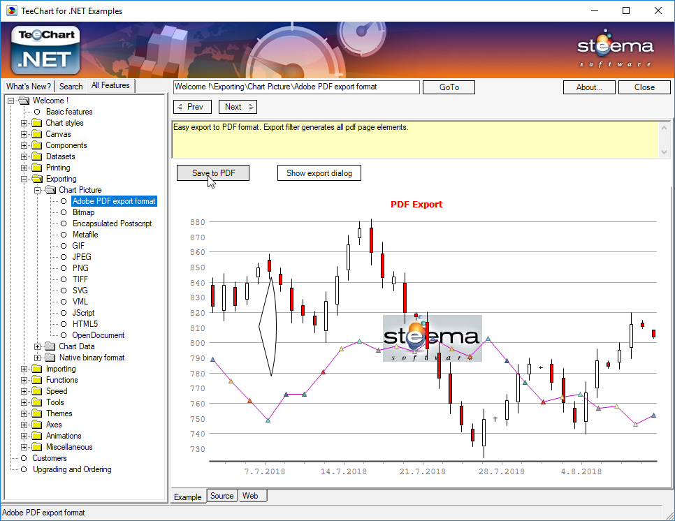

yes, there's an example of how to export to PDF in the Features Demo shipped with the TeeChart.NET Pro version:
the code in the 'Save to PDF' button looks like this:
    private void button1_Click(object sender, System.EventArgs e)
      saveFileDialog1.DefaultExt = tChart1.Export.Image.PDF.FileExtension;
      saveFileDialog1.FileName = tChart1.Name+ "."+saveFileDialog1.DefaultExt;
      saveFileDialog1.Filter=Texts.PDFFilter;
      if (this.saveFileDialog1.ShowDialog() == DialogResult.OK)
        tChart1.Export.Image.PDF.Save( saveFileDialog1.FileName );
