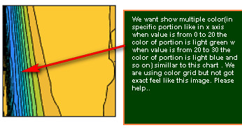

Hi Steema Support,
We are facing one issue regarding fill multiple color in line series. We are using the Dot Net TChart version 2012.
We want to show multiple color(in specific portion like in x axis when value is from 0 to 20 the color of portion is light green when value is from 20 to 30 the color of portion is light blue and so on) similar to below chart .
We are using color grid but not got exact feel like above image.
Thanks and Regards
Planoresearch

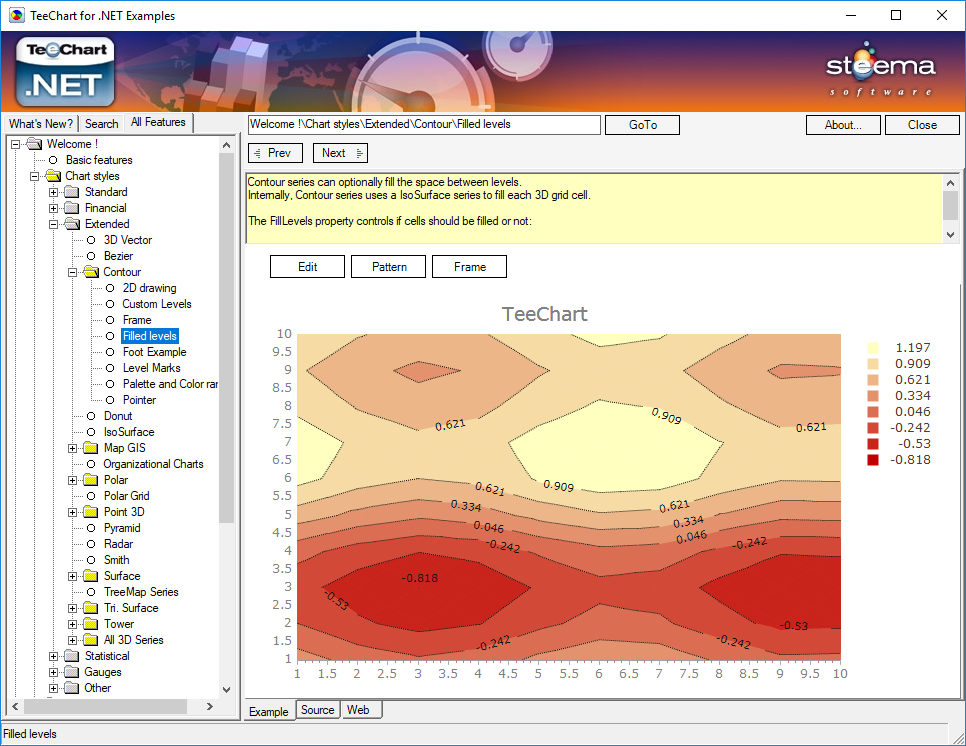

have you had a look at the Contour series? There are several demos in the Feature Demo:

But in "Filled Levels" example contrours setting color like this-
this.contour1.Brush.Color = System.Drawing.Color.FromArgb(((int)(((byte)(68)))), ((int)(((byte)(102)))), ((int)(((byte)(163)))));
this.contour1.EndColor = System.Drawing.Color.FromArgb(((int)(((byte)(192)))), ((int)(((byte)(0)))), ((int)(((byte)(0)))));
this.contour1.FillLevels = true;
this.contour1.StartColor = System.Drawing.Color.FromArgb(((int)(((byte)(255)))), ((int)(((byte)(255)))), ((int)(((byte)(192)))));
but actually tchart plot in diffrent way...why?
In start color chart setting light yellow color.
In End color chart setting dark brown color.(I am relating with as we set gradient color).
Query1. But chart showing many colors, i am unable to understand this.

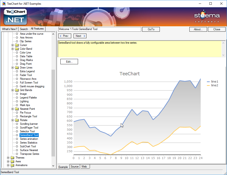

In which case, have you considered the SeriesBand tool?
you could add several of these between each of your line series.
