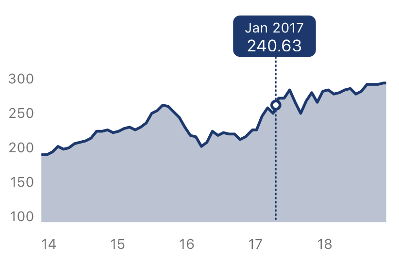

Any pointers on how to get my current line graph
Screen Shot 2018-04-20 at 14.38.34.png (34.8 KiB) Viewed 30396 times

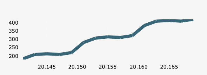

Looking more like
Screen Shot 2018-04-20 at 14.40.31.png (46.02 KiB) Viewed 30397 times
Some questions:
1. Somehow I still see the marks on the line of the cross sections, so the line is not 1 smooth full color line
2. How do you enable the color fill from the bottom axes to the line?
3. Is there any graph touch interaction possible on the xamarin forms version, so that the user can move it's finger over the graph and we show a label at the mark selected?
Pep
Posts: 3316
Re: Line graph detail
Post by Pep » Mon Apr 23, 2018 11:36 am
I'm just preparing a very similar example to you. I'll upload it on our Steema github account today. I'll advise.

I've uploaded a similar example on our github account which includes all the functionality you were asking. You can find it here :
https://github.com/Steema/teechart-xama ... PointerSTD

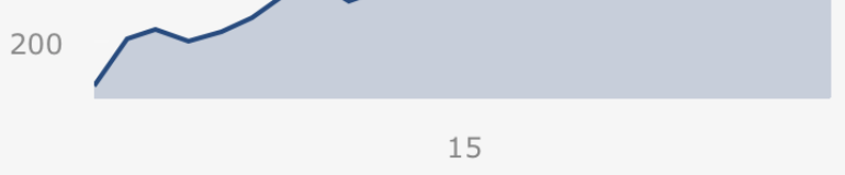

Only 1 small question still... if you look at my sample image, you will notice a 15 at the bottom.
This because I added DateTime values for the graph and set the Bottom Axes as follows:
AreaLineChart.Chart.Axes.Bottom.Increment = Steema.TeeChart.Utils.GetDateTimeStep(DateTimeSteps.OneYear);
AreaLineChart.Chart.Axes.Bottom.Labels.DateTimeFormat = "yy";
Now my question, although I increment per Year, the data also contains 2014 values. Can I make sure the left lower corner also has 14 visible?
Screen Shot 2018-04-25 at 10.47.12.png (13.93 KiB) Viewed 30334 times
Pep
Posts: 3316
Post by Pep » Fri Apr 27, 2018 1:51 pm
Hi Glenn,
some options here :
One way would by trying to add an extra offset for the bottom axis minimum and maximum :
chart.Axes.Bottom.MinimumOffset = 100;
If this doesn't help, you can also add custom axis labels manually , please take a look at the following post, and in the case you still having problems let me know, so we can try to find a solution :
http://www.teechart.net/support/viewtopic.php?t=8392
Bank Van Breda
Posts: 22
Joined: Tue Aug 08, 2017 12:00 am
Post by Bank Van Breda » Fri Apr 27, 2018 2:25 pm
Awesome, bottom.MinimumOffset and MaximumOffset does the trick, thanks!
