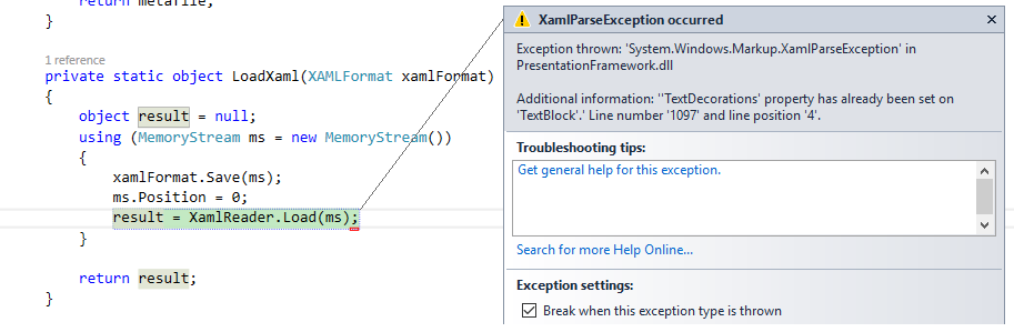

i have a problem in exporting teechart into XAML.
it seems like a bug in the control.
the issue is related to strike-through.
i attached a picture of the exception i get.
i cannot upload the xaml file also as a text because you block this extention.
here is the xaml
https://pastebin.com/et2uP7dX

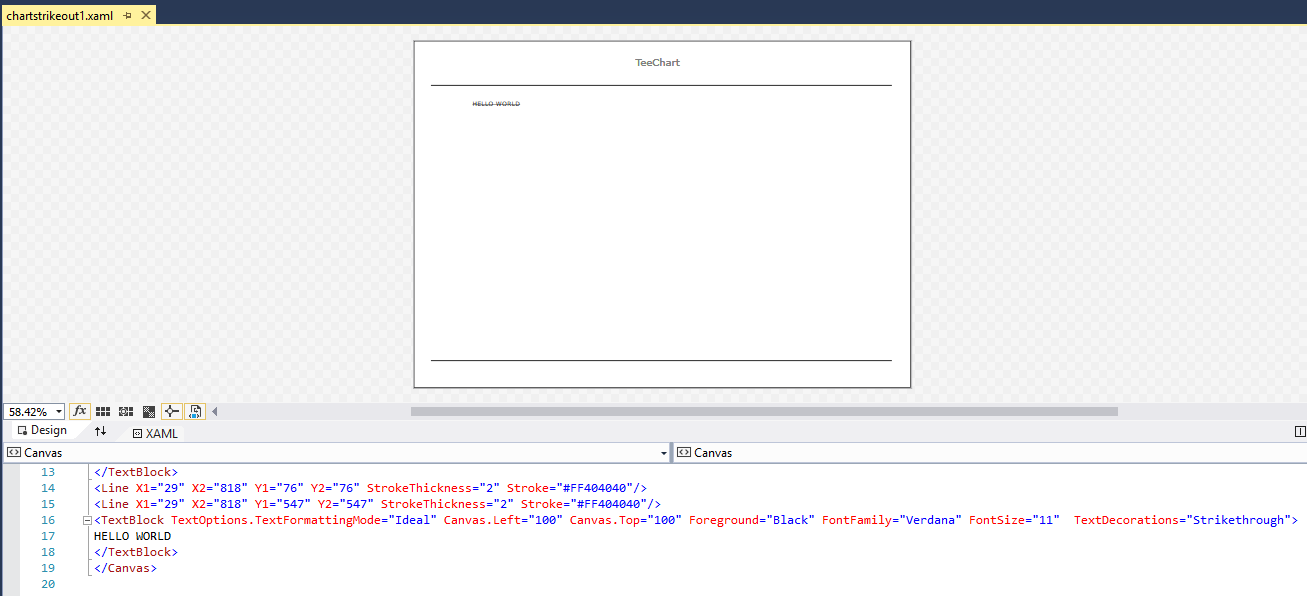

I have tested the code in this issue using TeeChart.dll version 4.1.2015.12163:
			InitializeChart();
		private void TChart1_AfterDraw(object sender, Graphics3D g)
			g.Font.Strikeout = true;
			g.TextOut(100, 100, "HELLO WORLD");
			tChart1.Export.Image.XAML.Save(@"C:\tmp\chartstrikeout1.xaml");
I then opened chartstrikeout1.xaml in Visual Studio:
this works as expected. Could you please give me the TeeChart code you used to create the xaml file you posted?

Strike-though works for us too, but there is some end case it doesn't work.
Sorry but i cannot post the code of our teechart, it's too long and complicated and scattered over many files.
you can maybe try to investigate what is different from the XAML i posted. the WPF property TextDecorations is set twice.
