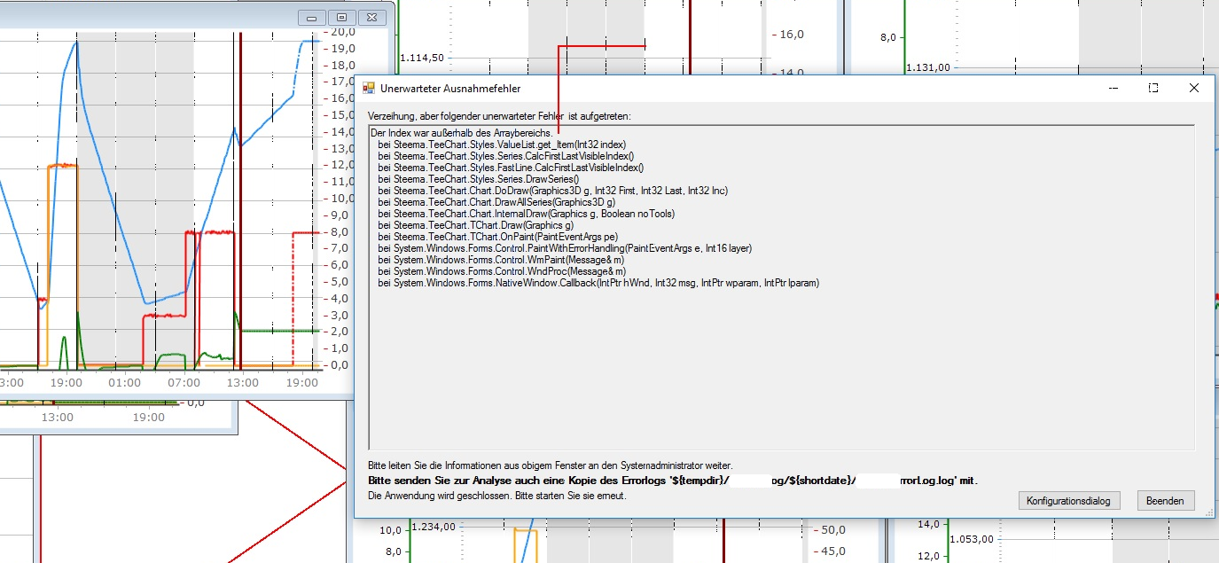

We get spurious error messages with "Index out of Bounds" Exceptions in Steema.TeeChart.Styles.ValueList
[img]TeeChartAbsturz-neueTeeChartVersion.png[/img]
We have an application that makes heavy use of background initialization and update of TeeChart Series.
:idea: Could it be that TeeChart ist not thread safe?

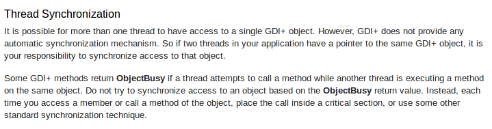

Wallenstein wrote: :idea: Could it be that TeeChart ist not thread safe?
It would be more accurate to say that GDI+ is not thread safe [from here]:
Screenshot from 2018-02-19 09-55-23.png (24.48 KiB) Viewed 16516 times
TeeChart has no automatic synchronization mechanism because GDI+ has no automatic synchronization mechanism, which means that if you are using a TeeChart object which refers to a GDI+ object in a multithreaded application you will have to 'place the call inside a critical section, or use some other standard synchronization technique.'

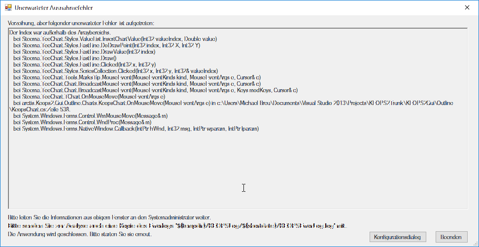

We have done various synchronizations in our applications. However we are still suffering from Index-Out-Of-Bounds problems:
As you see from this stacktrace, the FastLine Draw-Method is Inserting Values into the ValueList.
Why is it doing this? What points are here inserted? The FastLine was already be filled with all necessary points.

Wallenstein wrote: Why is it doing this? What points are here inserted? The FastLine was already be filled with all necessary points.
the FastLine series fills an internal valuelist with values when its Clicked() method is called as a speed optimization, and this Clicked() method is called by the MarksTip tool. Just by looking at the code I can't imagine why it should fail, and certainly all the tests I've run on the code haven't caused it to fail in this way, e.g.
			FastLine series1 = new FastLine(tChart1.Chart);
			series1.FillSampleValues(10000);
			series1.DrawAllPoints = false;
			MarksTip tool1 = new MarksTip(tChart1.Chart);
			tool1.Series = series1;
In order to resolve this issue I will need some code with which I can reproduce it here - could you please provide me with some?
