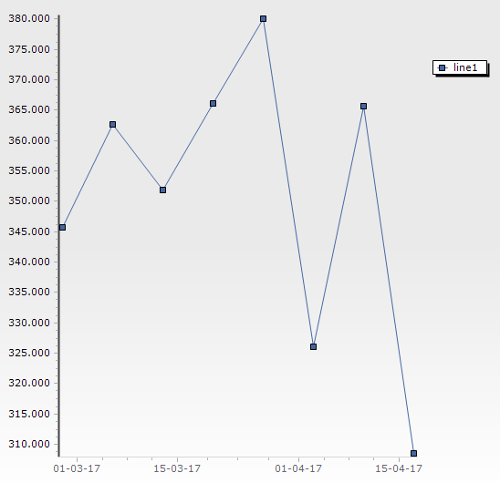

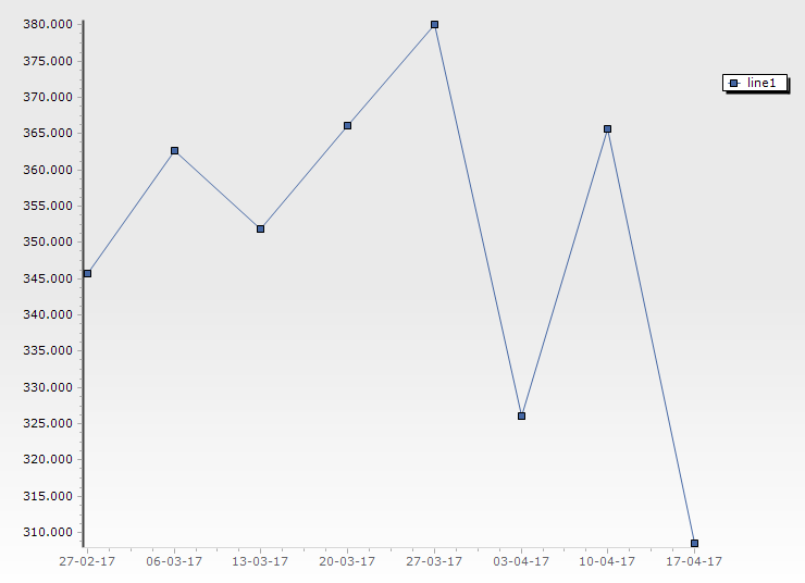

We're experimenting with some label styles and like the fact that when using AxisLabelStyle.PointValue, axis labels are all lined up with the chart points.
We also like the fact that when using AxisLabelStyle.Value, axis labels are nicely spread along the axis. When there is not enough space, the interval between labels is increased, so that labels stay spread equally over the axis.

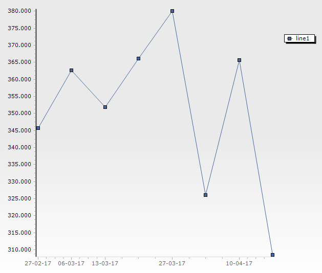

When there is not enough space when using AxisLabelStyle.PointValue however, individual labels are left out, depending on the available space, causing the labels not to be spread equally anymore.

AxisLabelStyle.Value - not enough space
AxisLabelStyle.PointValue - not enough space
AxisLabelStyle.PointValue - enough space
