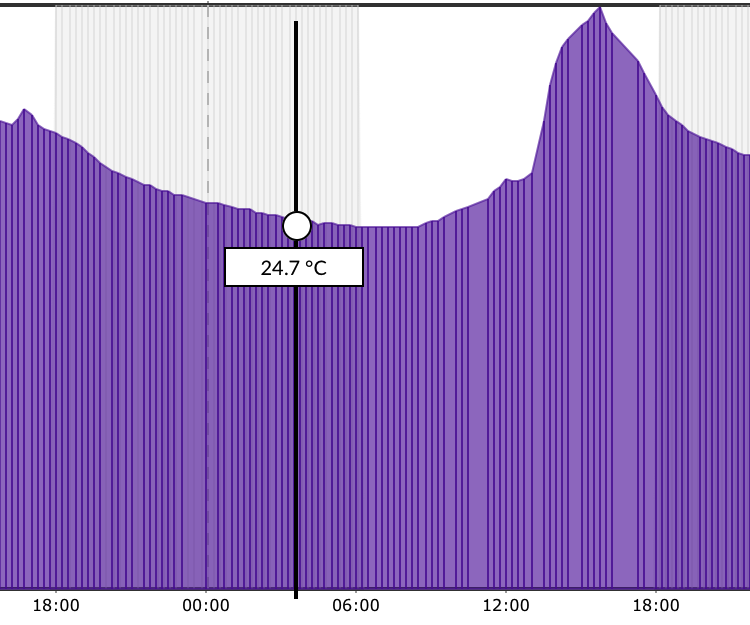

i am unable to get a proper transparency in my area?
I have tried setting it on the series and on the area and neither works.
if i use a argb color on the series it kinda works but then these lines show up and i cant hide them?
ie. series.Color = Color.FromArgb(58,214,214,214);
Simulator Screen Shot 16 Feb 2017, 4.10.04 pm.png (36.48 KiB) Viewed 11719 times

Unfortunately this did not help to get rid of the vertical lines. Any other suggestions?
