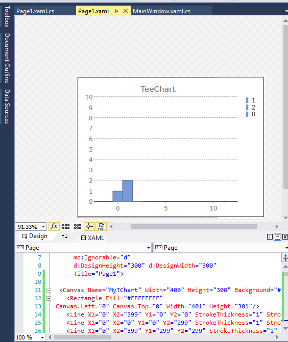

The following code:
		private void Button_Click(object sender, RoutedEventArgs e)
			Steema.TeeChart.WPF.Export.XAMLFormat xaml = MyTChart.Export.Image.XAML;
			xaml.Width = 400;
			xaml.Height = 300;
			xaml.Save(@"G:\temp\chart.xaml");
exports to file correctly. If I then copy and paste the canvas into a new Xaml page I obtain this:
I then modify the code to this:
			xaml.Width = 400;
			xaml.Height = 300;
			MemoryStream ms = new MemoryStream();
			xaml.Save(ms);
			ms.Position = 0;
			object exportedXaml = XamlReader.Load(ms);
And the XamlReader loads the stream correctly.
I think the issue is with using a Width and Height which is not big enough for all the elements you have in your chart.
