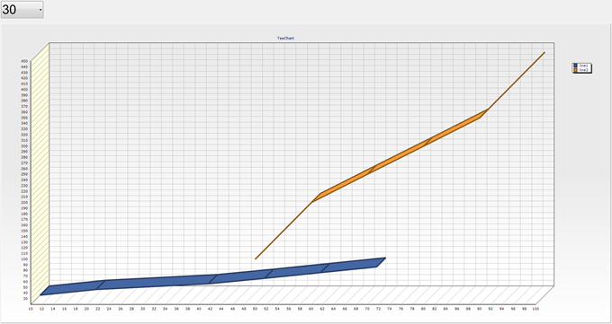

We are facing an issue regarding teechart Font size.
Here we added one Combo box, on teechart to set font.
Now here we want if we set combox value to 35(as shown in below image) then teechart header, labels, axis title and legend font or we can say all fonts that showing on chart should be set to 35 means as we set value from combobox all the teechart font should we managed accordingly.

Amol wrote: We want something like
Tchart1.Font=35;// Is we have something like this?
No, nothing like this exists in the TeeChart API at the moment. I have added this idea as an enhancement to TeeChart's issue tracker with id=1712 which does not guarantee its implementation but which does mean that it will be considered for inclusion into a future release.
