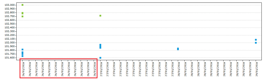

hi there, how can I prevent bottom label axis. please refer to image.

Hello!
You should be able to use the Axis.Increment value, for example:
      Points series = new Points(tChart1.Chart);
      DateTime today = DateTime.Today;
      Random rnd = new Random();
      for (int i = 0; i < 24; i++)
        series.Add(today, rnd.Next(100));
        today = today.AddHours(2);
      tChart1.Axes.Bottom.Increment = Utils.DateTimeStep[(int)DateTimeSteps.OneDay];
