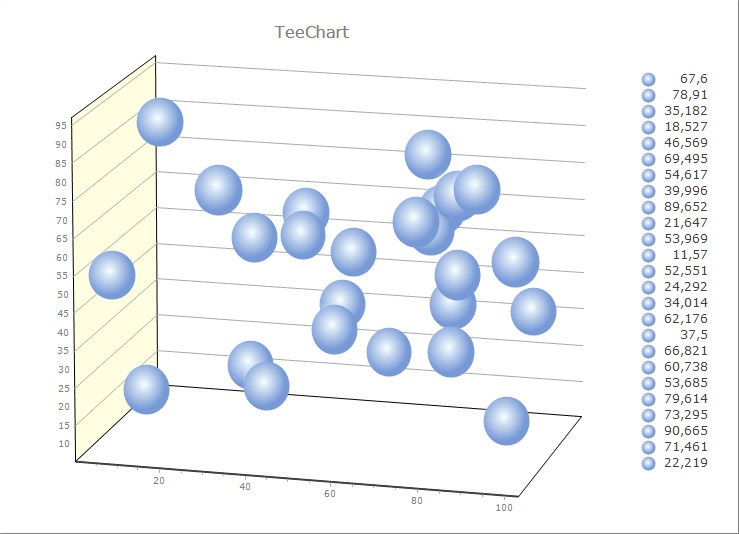

Are you sure Points3D is not what you want?
tChart1.Aspect.View3D = true;
tChart1.Aspect.Chart3DPercent = 60;
tChart1.Aspect.Zoom = 80;
Points3D series = new Points3D(tChart1.Chart);
series.FillSampleValues();
series.LinePen.Visible = false;
series.Pointer.Style = PointerStyles.Sphere;
series.Pointer.HorizSize = 30;
series.Pointer.VertSize = 30;

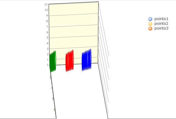

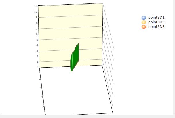

Attached is a snpashot of the three series which are red, blue, and green placed on the chart and then rotated with the rotate tool.
- ForUpload.JPG (23.9 KiB) Viewed 21290 times

If I modify the code above and replace Points3D with Points I get the series spread out along the Z plane but the points are still flat.
The Points series was what I started with and noticed that the points had no Z-dimension. I switched over to Points3D and it got worse because the points don't have a Z-Dimension size nor are they distributed along the Z axis.
- ForUpload2DPoints.JPG (23.41 KiB) Viewed 21281 times

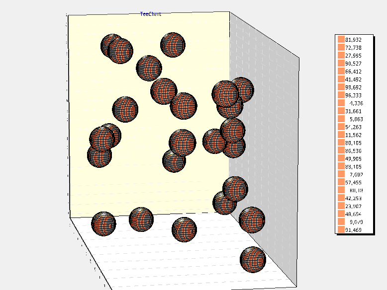

D:\Program Files (x86)\Steema Software\Steema TeeChart for .NET 2016 4.1.2016.05120\Examples\OpenGLProject\bin\ExecutableDemo\OpenGLDemo.exe
By adding TeeChart.OpenGL.dll to your project, you should be able to achieve something like this:
I see the issue now, apologies for not catching it the first time round. By default, TeeChart uses the default Windows Forms GDI+ canvas to render, and this canvas is not a 3D canvas. We do have a 3D canvas, however, an OpenGL canvas, a working example of which you can find on your harddisk under:biqpaulson wrote:The Points series was what I started with and noticed that the points had no Z-dimension.
TeeOpenGL openGL;
openGL = new TeeOpenGL(tChart1.Chart);
openGL.Active = true;
openGL.AmbientLight = 50;
tChart1.Aspect.Zoom = 50;
tChart1.Tools.Add(typeof(Rotate));

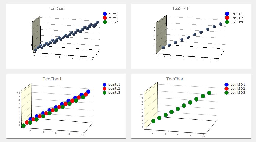

After lots of testing with the opengl library I cannot get what you have.
1) All I get is a big red X where the graph belongs if I use either Sphere or PolishedSphere. No exceptions in the Output window or any indication that there was a problem.
2) Nothing is 3D except for the Circle (funny that a circle is actually a sphere using the opengl library with Points3D and Points but the Sphere and PolishedSphere do not work).
3) Using the circle PointerStyle and Points3D Style I still get overlapping series in the Z-Axis. Using circle PointerStyle and Points I get the series spread over the Z-Axis appropriately.
4) Now no coloring of the "circles" work.
Imports Steema.TeeChart
Public Class Form1
Private Sub Form1_Load(sender As Object, e As EventArgs) Handles MyBase.Load
DrawSeries(TChart1)
DrawSeries(TChart2)
DrawSeries3D(TChart3)
DrawSeries3D(TChart4)
Private Sub FormatChart(chartToFormat As TChart)
chartToFormat.Aspect.View3D = True
chartToFormat.Aspect.Orthogonal = False
chartToFormat.Aspect.Chart3DPercent = 60
chartToFormat.Aspect.Zoom = 80
chartToFormat.Tools.Add(New Steema.TeeChart.Tools.Rotate)
Private Sub DrawSeries(chartToDraw As TChart)
FormatChart(chartToDraw)
OneSeries(chartToDraw, Color.Blue)
OneSeries(chartToDraw, Color.Red)
OneSeries(chartToDraw, Color.Green)
Private Sub DrawSeries3D(chartToDraw As TChart)
OneSeries3D(chartToDraw, Color.Blue)
OneSeries3D(chartToDraw, Color.Red)
OneSeries3D(chartToDraw, Color.Green)
Private Sub OneSeries(chartToAddTo As TChart, seriesColor As Color)
Dim newSeries As Styles.Points = New Steema.TeeChart.Styles.Points
chartToAddTo.Series.Add(newSeries)
newSeries.Color = seriesColor
For i = 1 To 10
newSeries.Add(i, i, seriesColor)
Next
newSeries.Pointer.HorizSize = 10
newSeries.Pointer.VertSize = 10
newSeries.LinePen.Visible = False
newSeries.Marks.Visible = False
newSeries.Pointer.Style = Steema.TeeChart.Styles.PointerStyles.Circle
Private Sub OneSeries3D(chartToAddTo As TChart, seriesColor As Color)
Dim newSeries As Styles.Points3D = New Steema.TeeChart.Styles.Points3D
For i = 1 To 10
Next
End Class
- ForUploadOpenGL.JPG (68.1 KiB) Viewed 21265 times

Oh, I should add another item. The drawing using the OpenGL library is the worse I have seen. Not only do the balls (albeit from circle styles) look not very good but the lines on the graph are just plain horrid.
- Guru
- Posts: 1603
Re: Bubbles are not bubbles in 3D
I agree that the quality of TeeChart's OpenGL output could be substantially improved. I will say that part of the reason little time has been dedicated to this part of the TeeChart.NET project is because we have had very little demand for OpenGL in the last five years or so, I can't remember any of our clients asking for improvements in this area. Anyhow, I have added this as a ticket to our issue tracker with id=1642 and will also comment on this to the product manager.biqpaulson wrote:Oh, I should add another item. The drawing using the OpenGL library is the worse I have seen. Not only do the balls (albeit from circle styles) look not very good but the lines on the graph are just plain horrid.
