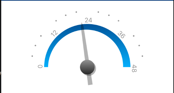

I'm creating a circular gauge in Xamarin forms, and I'm trying to change the label's color. I tried setting every property I could find, but it won't change... Can anyone help me?
this is my code: (just setting the property of the axis labels color here, because that's the one I think needs to be set... I also tried it with many other properties I found, but none are working).

In attachment the screenshot of my gauge, I want to change the color of the numbers on the axis
Thanks!

I tried that too, and it isn't working either...

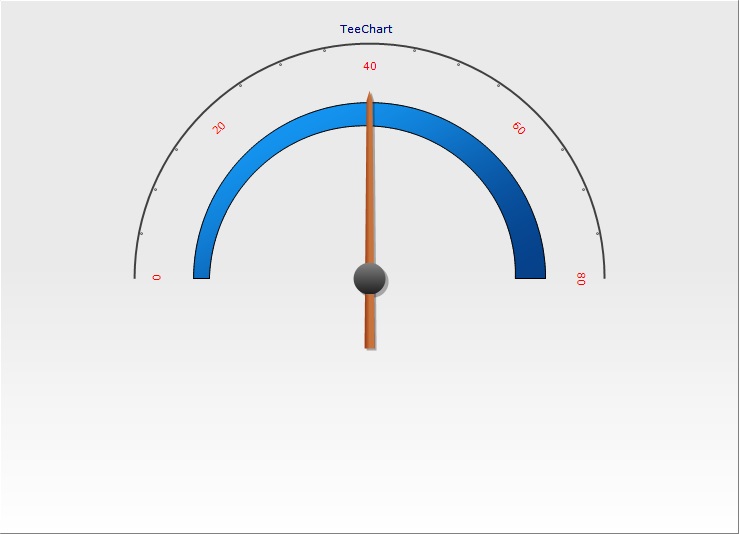

The following code works as expected with TeeChart.dll, the Windows Forms version:
      Func<int> GetCurrentValue = () =>
        return 40;
      Func<int> GetMonths = () =>
        return 80;
      CircularGauge gauge = new CircularGauge(tChart1.Chart);
      gauge.Frame.Visible = false;
      gauge.FaceBrush.Visible = false;
      gauge.DisplayTotalAngle = 180;
      gauge.TotalAngle = 180;
      gauge.Value = GetCurrentValue();
      gauge.Ticks.Visible = false;
      gauge.Minimum = 0;
      gauge.Maximum = GetMonths();
      gauge.Axis.Increment = GetMonths() / 4;
      gauge.RedLine.Visible = false;
      gauge.GreenLineStartValue = 0;
      gauge.GreenLineEndValue = GetMonths();
      gauge.GreenLine.Gradient.Direction = LinearGradientMode.ForwardDiagonal;
      gauge.GreenLine.Gradient.StartColor = Color.FromArgb(255, 6, 64, 137);
      gauge.GreenLine.Gradient.EndColor = Utils.HexToColor("FF159DFB");
      gauge.GreenLine.Pen.Visible = true;
      gauge.Axis.Labels.Font.Color = Color.Red;
gives me this:
Which version of TeeChart are you using?
