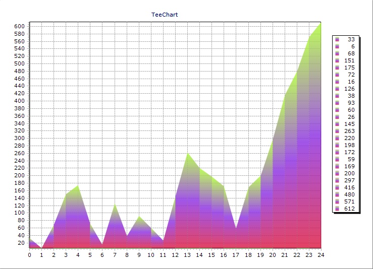

Thanks for reply, the first workaround works. However, I have another problem. When I use transparency and want to hide area lines, 1px-wide gaps appear. Can be reproduced with:
Area area = new Area();
area.Color = Color.GreenYellow;
area.AreaBrush.Gradient.StartColor = Color.GreenYellow;
area.AreaBrush.Gradient.MiddleColor = Color.BlueViolet;
area.AreaBrush.Gradient.EndColor = Color.Crimson;
area.AreaBrush.Gradient.UseMiddle = true;
area.AreaBrush.Gradient.Visible = true;
area.AreaBrush.Gradient.Transparency = 20;
area.AreaLines.Visible = false;
area.FillSampleValues();
chart.Series.Add(area);

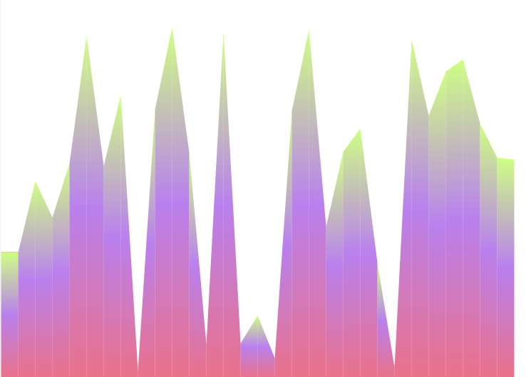

This is how it looks:
This only happens if transparency is used. If I set GradientRelative to false, gaps dissapear, but some other problem pops up, so I'd like to avoid it. It worked in 2.0.2652.22325.

Yes, I can reproduce this issue here. However, it seems specific to a theme that did not exist in version 2. If you use an older theme, then this effect is not present, e.g.

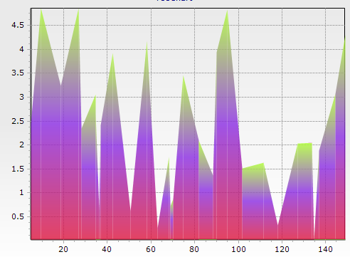

Unfortunately, this doesn't work for me if the data is irregular:
var x = 0d;
for (int i = 0; i < 30; i++)
    x = random.NextDouble()*10 + x;
    var y = random.NextDouble()*5;
    area.Add(x, y);
chart.CurrentTheme = ThemeType.Opera;

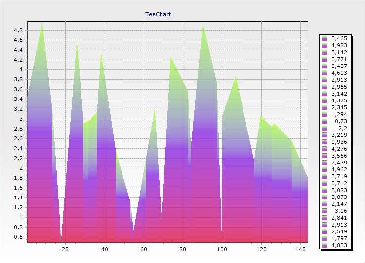

This produces:

Post by Christopher » Thu Sep 01, 2016 10:08 am
The answer here is to change the SmoothingMode, e.g.
    Random random = new Random();
      tChart1.CurrentTheme = ThemeType.Opera;
      tChart1.Graphics3D.SmoothingMode = SmoothingMode.HighSpeed;
      area.AreaBrush.Gradient.GammaCorrection = true;
      area.LinePen.Visible = false;
      var x = 0d;
      for (int i = 0; i <= 30; i++)
        x = random.NextDouble() * 10 + x;
        var y = random.NextDouble() * 5;
        area.Add(x, y);
      tChart1.Series.Add(area);

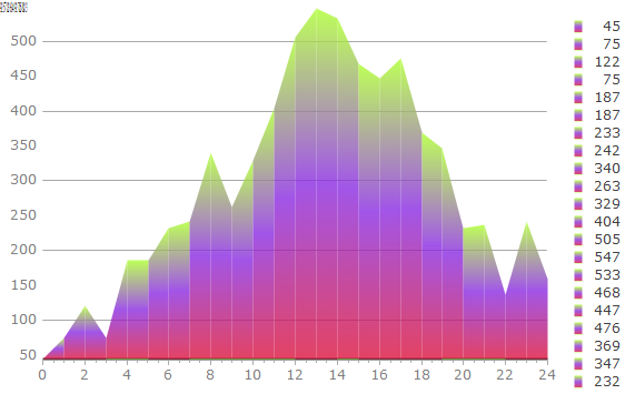

which gives me:
FYI, you can see this effect outside of TeeChart, e.g. in a UserControl:

use of which gives me:

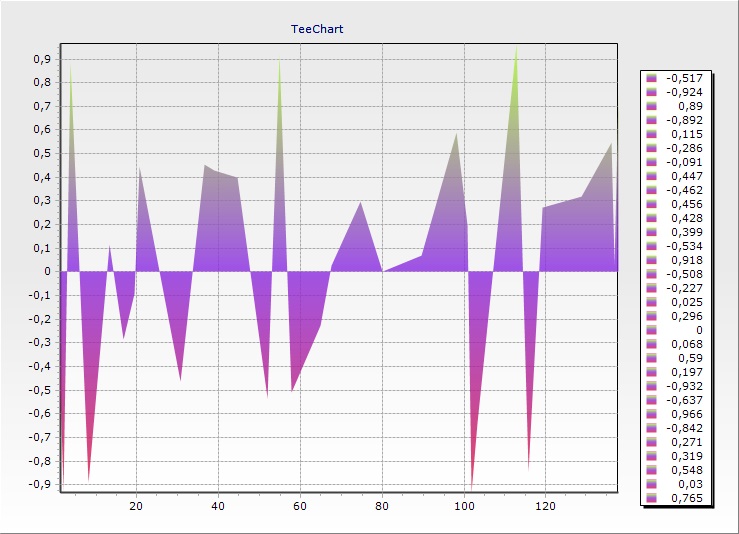

I get this chart:
Is this not what you expect?

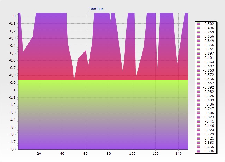

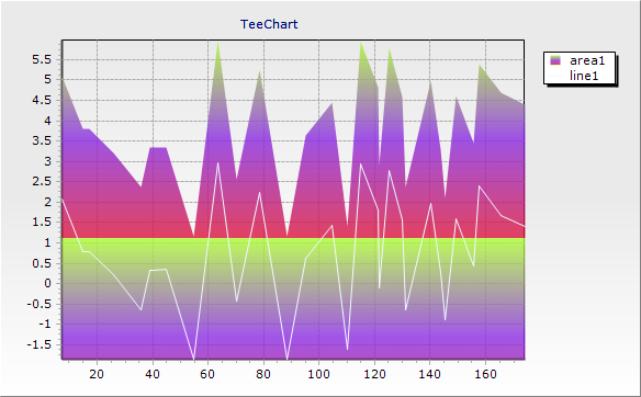

I reproduced the problem in a sample app. It's not actually below 1 and not solid color (that was true for the data and settings in my actual application), but rather a "restarted" gradient below lowest y-value of an area. It happens when there are more multiple series. It looks like a rectangle is drawn below an area chart and its gradient is drawn separately from area above it:
            var data = GetData();
            area.Color = StartColor;
            area.GradientRelative = false;
            SetData(area, data);
            Line line = new Line();
            line.Color = Color.AliceBlue;
            var newData = data.Select(p => new Point(p.X, p.Y - 3));
            SetData(line, newData);
            chart.Series.Add(line);

Post by Christopher » Thu Sep 08, 2016 9:12 am
Okay, thank you, I think I can see what's happening - if I use this code:
      //area.Origin = 0;
      //area.UseOrigin = true;
      var x = 0d;
        double y = random.NextDouble();
        bool flag = random.NextDouble() < 0.5;
        y = flag ? y : y * -1;
        area.Add(x, y);
and then use the mouse to scroll the chart upwards, I get this:
I have added this to our issue tracker with id=1625.
Christopher Ireland / Development & Support
