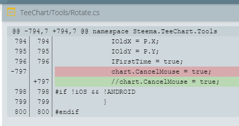

Re: Rotate does not work with Legend Checkboxes
Post by Christopher » Wed Aug 31, 2016 7:57 am
DEV1 wrote:In case it gets delayed, I would like to know what I need to change for the source code.
Of course - the change is here:
Post by Christopher » Thu Jan 26, 2017 12:12 pm
PidoTech wrote:Is this issue fixed yet? I want to know if this issue has been fixed.
Yes, that change is in the last publicly available release - ID1612 here.
