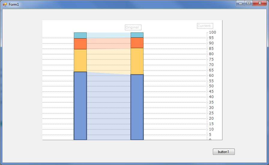

I am trying this using designer only .
1) Is it possible to shift bar graph left ?
2) Can i remove 0 gridline ( bottom most) gridline and show 100% gridline
[img]
Amortization Graph.png (60.84 KiB) Viewed 21564 times
[/img]
Source code : https://github.com/dekajp/DealViewChart ... esigner.cs

I am able to acheive what i need by deriving Bar Class. As you can see in the image. But i want to achive this in After Draw event.
Is this possible in After draw event . If No , then i would like to use TEN file and load this class. but every time i try to do . I am getting reflection error.

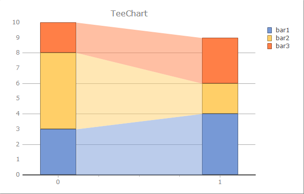

Here's a coded example.
      bar1.MultiBar = MultiBars.Stacked;
      bar1.Add(3);
      bar1.Add(4);
      bar2.Add(5);
      bar2.Add(2);
      bar3.Add(2);
      bar3.Add(3);
      bar1.BarWidthPercent = 30;
      bar2.BarWidthPercent = 30;
      bar3.BarWidthPercent = 30;
    private void tChart2_AfterDraw(object sender, Graphics3D g)
      for (int s = 0; s < tChart2.Series.Count; s++)
        Point[] poly = new Point[4];
        for (int i = 0; i < tChart2.Series[0].Count; i++)
          Bar aBar = ((Bar)tChart2[s]);
            if (i == 0)
              if (s == 0)
                poly[0] = new Point(aBar.CalcXPos(i) + aBar.BarBounds.Width, tChart2.Axes.Bottom.Position);
                poly[0] = new Point(aBar.CalcXPos(i) + aBar.BarBounds.Width, ((Bar)tChart2[s-1]).CalcYPos(i));
              poly[1] = new Point(aBar.CalcXPos(i) + aBar.BarBounds.Width, aBar.CalcYPos(i));
              poly[2] = new Point(aBar.CalcXPos(i), aBar.CalcYPos(i));
              if (s == 0)
                poly[3] = new Point(aBar.CalcXPos(i), tChart2.Axes.Bottom.Position);
                poly[3] = new Point(aBar.CalcXPos(i), ((Bar)tChart2[s - 1]).CalcYPos(i));
          g.Pen.Visible = false;
          g.Brush.Color = aBar.Color;
          g.Brush.Transparency = 50;
        g.ClipRectangle(tChart2.Chart.ChartRect); //don't paint polygon out of bounds on zooms
        g.Polygon(poly);
        g.UnClip();

Thank You , this worked.
