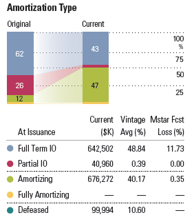

We were using Teechart 2005 .net. Would like to upgrade to Tee Chart 2016. So i downloaded 2016 , i could not figure out which component or chart to use to draw this graph. Is it possible to draw a stack graph without any margin , axis and border.

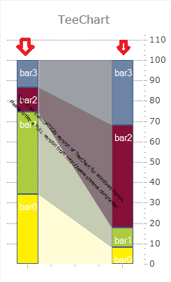

Yes , this part i got it . here in the attached image. Can you please help me to how i should approach the missing part in between stacked graph

Thanks for your help. I am able to draw 2 bar graph with random values adding upto 100.
What i would like is to draw in between 2 bars . As shown in figure i want to draw line and then fill them with some color

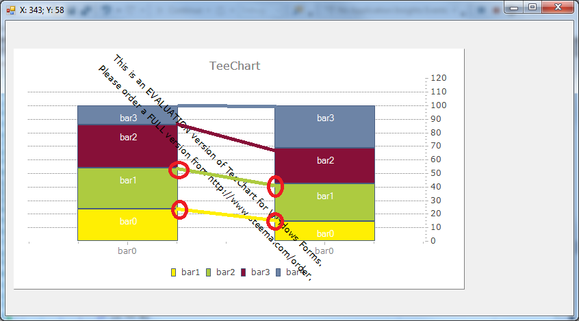

I think can be useful for you, use a SeriesBandTool. Attached you find a simple example shows you how can do that.

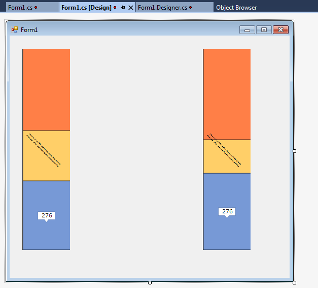

thanks for the help. I could able to get a chart very close . but i am missing labels at top and Also i need to make Y axis ( 0,25,50,75,100)
I did by inheriting Bar class. But doing so my designer is not working. Is there a way to fix it.

To fix the problem you're experiencing you need only change the MarkStyle Value. The code below shows you how:
bar.Marks.Style = Steema.TeeChart.Styles.MarksStyles.Value;
