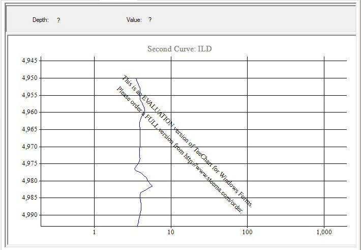

OK, the NOOB has figured out a few things, but not everything.
I have been able to spread out my chart vertically by using Paging options in the Editor. However, I have been unable to control, using the Editor, keeping the vertical scrolling from going past the vertical endpoints of the series.
It seems that scrolling and paging support in the vertical is something new that the T-Chart folks don't fully support with their editor, tools, and even in code. It's going to take some work to figure out all of the side-effects of changing properties and getting it all to work correctly.
Here's a screenshot of what I'm talking about attached. The data in the series goes vertically from values of 4950 to 5380. Note how the scrolling goes past the lower limit of the data in the series (I have inverted this axis to show increasing values downward).
I haven't figured out how to show the log bottom axis vertically in a grid from top to bottom of the chart, to include not just the decades, but also the values from 2 through 9. Any clues?
Can't just add a paging control. It wants to do horizontal.
Can't just add code to control the vertical without affecting other properties, have to be careful how to do it. Changing properties willy nilly has unpredictable effects on other properties, breaking the parts of the current formatting that work as desired.
Here's my code to control the component and load it with data:

- T-Chart_MikeR.jpg (142.34 KiB) Viewed 13902 times

Thanks, I was able to resolve my issues with vertical scrolling by banging around a bit with hints that Sandra gave me before she went on vacation break, about using the Scroll event.
Here is what I did:
myVScrollBar.Dock = DockStyle.Right;
tChart1.Controls.Add(myVScrollBar);
myVScrollBar.Scroll += MyVScrollBar_Scroll;
tChart1.Zoom.Direction = Steema.TeeChart.ZoomDirections.None;
tChart1.Panning.Allow = Steema.TeeChart.ScrollModes.None;
These lines of code are necessary to disable the right mouse button from scrolling or paging, because the chart will not disable paging just manipulating the visible properties in the Visual Studio design view. Don't know why not. No time to figure it out. Here is my scrolling handler. I notice that when you click in the vertical scrollbar, the scroll event will trigger on BOTH mouse down AND mouse up. On mouse up, the position has not changed, but that needs to be detected and properly ignored or the logic will fail. My data series is stored in an ArrayList called mapTheDoubles. I convert it to an Array and feed it to the chart component.
private void MyVScrollBar_Scroll(object sender, ScrollEventArgs e)
// Handle mouse up which is bogus!
if (e.NewValue == e.OldValue) return;
bool bDirectionIsDown = e.NewValue > e.OldValue;
if (mapTheDoubles.Count > 0)
// Check initial state
if (yMin == 0.0)
yMin = (double)mapTheDoubles[0];
yMax = yMin + 50.0;
// Now perform the scroll
if (bDirectionIsDown)
yMin += 50.0;
yMax += 50.0;
yMin -= 50.0;
yMax -= 50.0;
// Final check on boundaries
if(yMin < (double)mapTheDoubles[0])
yMax = yMin + 50.0;
if(yMax > (double)mapTheDoubles[mapTheDoubles.Count - 1])
yMax = (double)mapTheDoubles[mapTheDoubles.Count - 1];
yMin = yMax - 50.0;
tChart1.Axes.Left.SetMinMax(yMin, yMax);
There's more to be done about scaling the scrolling thumb size to work nicely with the series limits and size, but this was close enough as is. It works.
Thanks for your assistance and attention.
