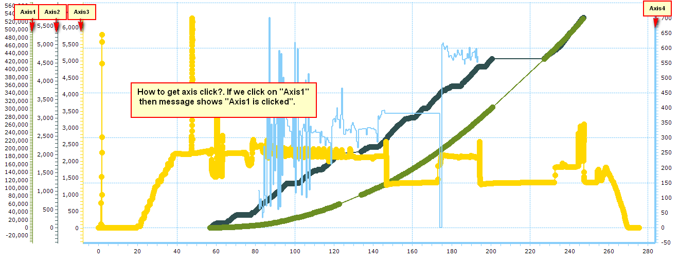

We have one regarding how to get axis click or double click on Multiple Custom axis as shown in attached image.
In this i have four custom axis and i want to get that particular axis when i click or double click on axis.
custom multiple axis.
Custom multiple Axis.png (31.62 KiB) Viewed 7331 times
Kindly suggest any solution asap.

Yes, you should be able to use code such as this:
      Line line1 = new Line(tChart1.Chart);
      Line line2 = new Line(tChart1.Chart);
      Axis axis = tChart1.Axes.Custom.Add();
      axis.RelativePosition = 20;
      line2.CustomVertAxis = axis;
      line1.FillSampleValues();
      line2.FillSampleValues();
      tChart1.ClickAxis += TChart1_ClickAxis;
    private void TChart1_ClickAxis(object sender, MouseEventArgs e)
      Axis axis = sender as Axis;
      string message = "";
      int custIndex = tChart1.Axes.Custom.IndexOf(axis);
      if (custIndex > -1)
        message = "Custom Axis " + custIndex.ToString();
        if(tChart1.Axes.Left.Equals(axis))
          message = "Left Axis";
        else if(tChart1.Axes.Bottom.Equals(axis))
          message = "Bottom Axis";
      MessageBox.Show(message);
