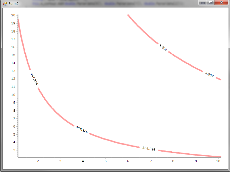

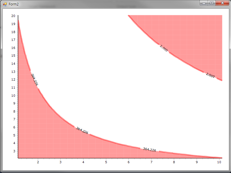

DEV1 wrote: Currently, I set UpToValue to 364.2261. When I change UpToValue to 364.226, it does not color the region anymore.
I'm afraid I can't reproduce this issue using the latest version of TeeChart, as can be seen in this video:
http://screencast.com/t/7cVxLsIwNFvz

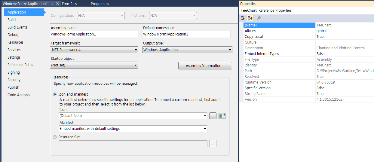

I am attaching three screenshots to show the issue that you were not able to reproduce.
As I was watching your video, I noticed that the version you are using is not really the same.
A file named Version.png displays what is our T-Chart is as well as Target Framework.
A file named 364.2261.png displays a T-Chart with proper coloring when UpToValue is set at 364.2261.
A file named 364.226.png displays a T-Chart with improper coloring when UpToValue is set at 364.226.

DEV1 wrote: I would like to investigate this matter further as it is very important for us to make sure that this behavior is never produced.
I have found the cause of this issue and have already fixed it. Unfortunately, unless you have the TeeChart source code, there is no workaround that can be applied. The fix will be included in the next maintenance release, due out within the next few working days.

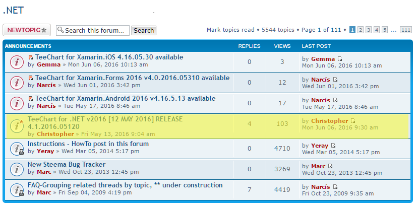

The new maintenance release was announced nearly a month ago at the top of this forum, as you can see here:
I can affirm that a fix to your issue is included in this release.
