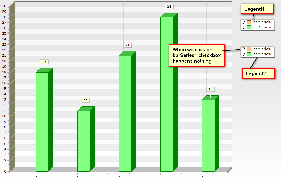

Hi steema support,
We are facing an issue regarding multiple legends,
Why checkbox of legend 2 is not working independently?
We wants to work on checkbox of legend 2.
Multiple Legends.rar
Demo
(58.97 KiB) Downloaded 1221 times
Please provide me any solution asap.

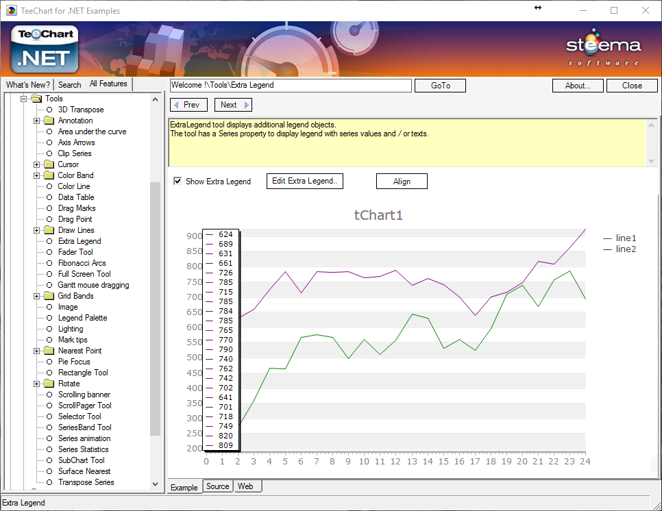

amol wrote:We are facing an issue regarding multiple legends,
I'm not sure what you are trying to achieve with more than one legend, but I think you might like to consider use of the ExtraLegend tool, e.g.

Hi steema,
Thanks for your prompt reply.
As you suggested we have gone through with the ExtraLegend tool, but here also we are unable to check/uncheck the series that is showing in the tool.
Basically our need is to check/uncheck checkboxes of the legend 2.
Is there is any other way to create Custom legend?
