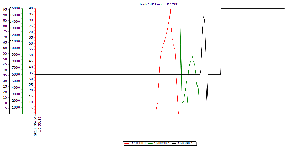

I am facing issue of starting the X-axis label value from the leftmost position of the chart and same for all Y-axis.
I have checked below request and implemented same. However, it doesn't solve my issue. Please suggest.
http://www.teechart.net/support/viewtop ... 74&p=70489
Attached sample project for your reference.
Trend.zip
(4.68 KiB) Downloaded 725 times

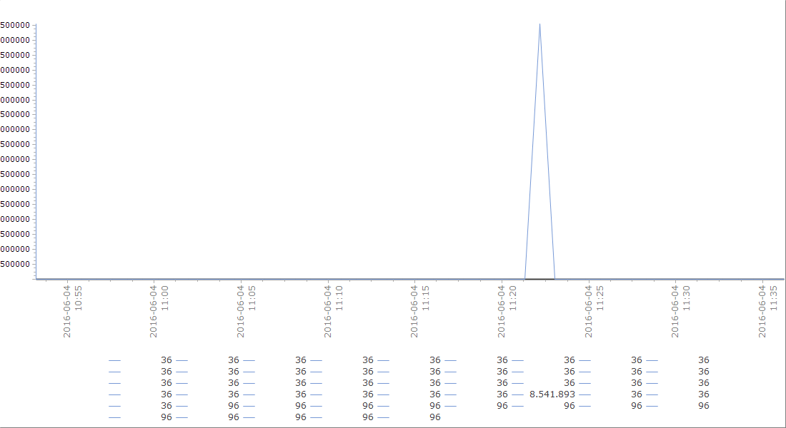

And the result is this:
Is this what you would expect?
Also, I cannot see in this code any attempt to implement the solution you mentioned in your first message in this thread - should I be able to see in this code where you have attempted to implement it?

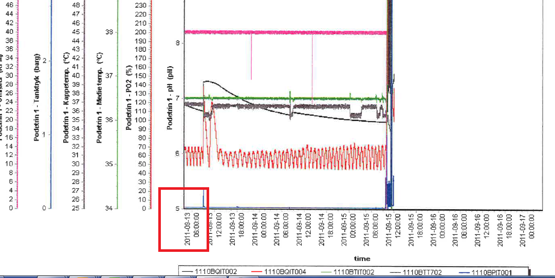

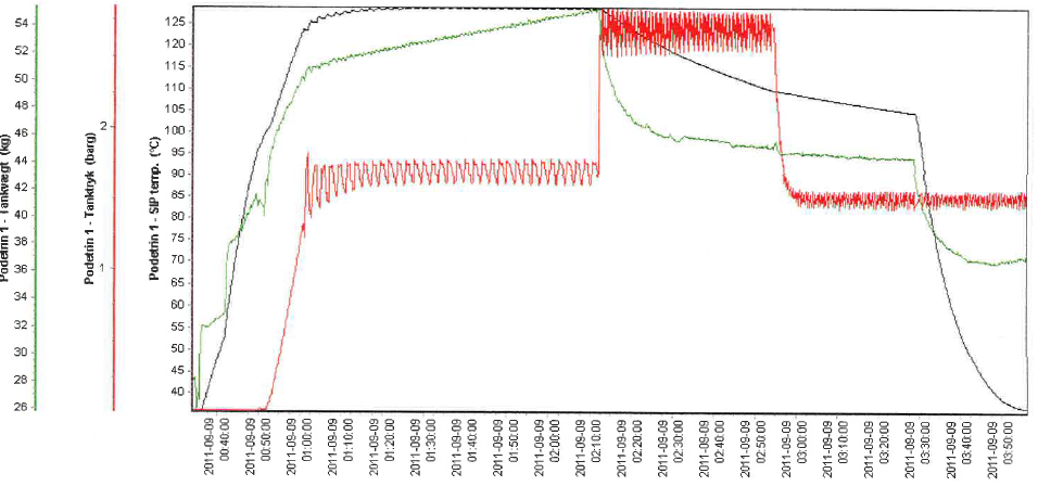

The issue is starting position of X-axis and Y-axis values. I would expect the chart as per attached. Also, the code I tried is in tChart1_AfterDraw method.

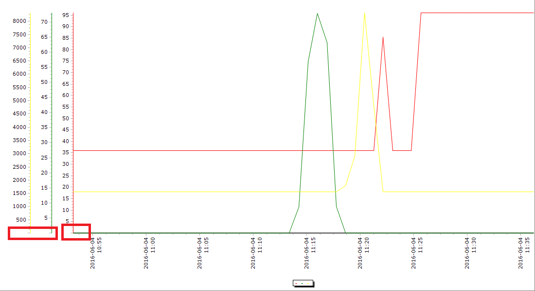

I tried to implement technique as mentioned in your reply. However, it is showing just one value as shown in the screenshot. Also, Y-axis values are not started from the same position.

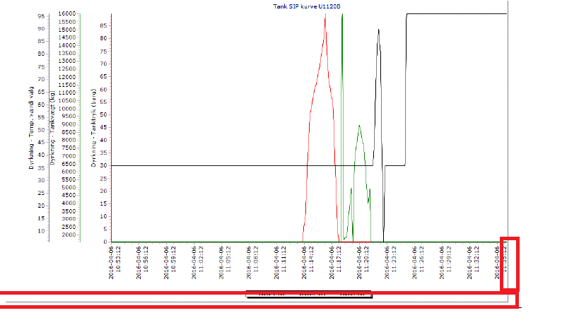

Please find attached code for your reference. Also, can you check the issue of displaying 0 value on Y-axis.

and I obtain the following chart:
Again, I'm afraid cannot see any attempt to implement the coding technique I mentioned in my last message to you. Could you please clarify whether you simply want me to implement this code for you?

I think I've got a couple of solutions for you. Firstly the zero that does not appear on the custom axis - this is due to the custom valueformat, which should be changed to this:
WebChart1.Chart[0].CustomVertAxis.Labels.ValueFormat = "####0;{####0};
and the singular label on the bottom axis was because, for your data, the increment was set too high:
double inc = 1.0 / 480.0; //five minutes
I hope that helps.

Need your inputs on removing the border (bottom line) marked in attached screenshot (Trend_chart1). We need the border to just chart area as attached in screenshot (Trend_chart2)
Re: Bottom and Custom Vertical Axis Label Start Position
Post by Christopher » Wed May 25, 2016 3:21 pm
Priyanka wrote: Thanks. It solved both issues :)
You're welcome, I'm very glad to hear it!
Priyanka wrote: Need your inputs on removing the border (bottom line) marked in attached screenshot (Trend_chart1). We need the border to just chart area as attached in screenshot (Trend_chart2)
You can try:
WebChart1.Chart.Panel.Bevel.Inner = BevelStyles.None;
WebChart1.Chart.Panel.Bevel.Outer = BevelStyles.None;

Post by Priyanka » Thu May 26, 2016 9:10 am
Hi Christopher,
I tried it but no luck.
