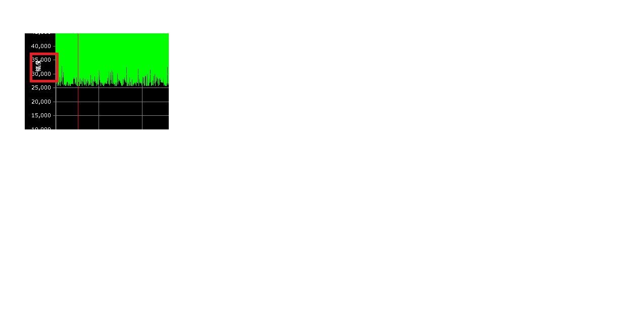

I hava two Problems,please help me.
Frist,Look the picture axis labels and title overlaping for many vertical axes.I want title on the left all the time,What should I do ?
Second,I want to draw a curve.when I set line.Smoothed = true; the Interface is not refresh. What should I do ?
Re: axis labels and title overlaping for many vertical axes
Post by Christopher » Wed Mar 30, 2016 1:14 pm
Chinfot wrote: Frist,Look the picture axis labels and title overlaping for many vertical axes.I want title on the left all the time,What should I do ?
You can use the CustomSize property, e.g.
      tChart1.Axes.Left.Title.Text = "Left Title";
      tChart1.Axes.Left.Title.Angle = 90;
      tChart1.Axes.Left.Labels.CustomSize = 100;
