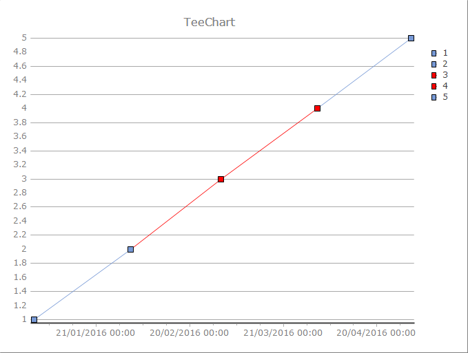

I have this test code
            line1.Add(new DateTime(2016,1,1), 1);
            line1.Add(new DateTime(2016, 2, 1), 2);
            line1.Add(new DateTime(2016, 3, 1), 3, Color.Red);
            line1.Add(new DateTime(2016, 4, 1), 4, Color.Red);
            line1.Add(new DateTime(2016, 5, 1), 5);
Where I put two points in a different color. Then I see the line between second and third points is red although the second point is not red. How could I make teechart to change the color line only if both points are changed?
I mean in the example I would like only to be red the line between third and 4th points.
