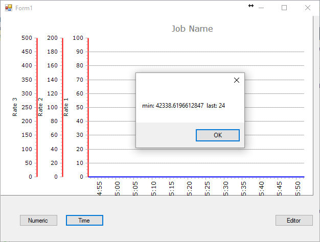

tirby wrote: However, the traces disappear.
If I do this:
  Private Sub Button2_Click(sender As System.Object, e As System.EventArgs) Handles Button2.Click
    'Time Mode
    Dim aa As Integer
    Dim bb As DateTime
    Dim cc As DateTime
    For aa = 0 To 7
      TChart1.Series(aa).XValues.DateTime = True
    Next aa
    TChart1.Axes.Bottom.Labels.DateTimeFormat = "MM/dd/yyyy HH:mm"
    TChart1.Axes.Bottom.Labels.Angle = 90
    bb = Now
    cc = bb.AddMinutes(60)
    TChart1.Axes.Bottom.Minimum = bb.ToOADate()
    TChart1.Axes.Bottom.Maximum = cc.ToOADate()
    TChart1.Axes.Bottom.Increment = (TChart1.Axes.Bottom.Maximum - TChart1.Axes.Bottom.Minimum) / 12
    Dim min As Double = TChart1.Axes.Bottom.Minimum
    Dim first As Double = TChart1(0)(TChart1(0).Count - 1).X
    MessageBox.Show("min: " + min.ToString(CultureInfo.InvariantCulture) + "  last: " + first.ToString())
I obtain this:
Here we have the reason why the series disappears - the largest X Value of the first series is much smaller than the minimum value of the bottom axis. This is because the time values on the bottom axis are OLE Automation Dates, about which you can read a little here.
