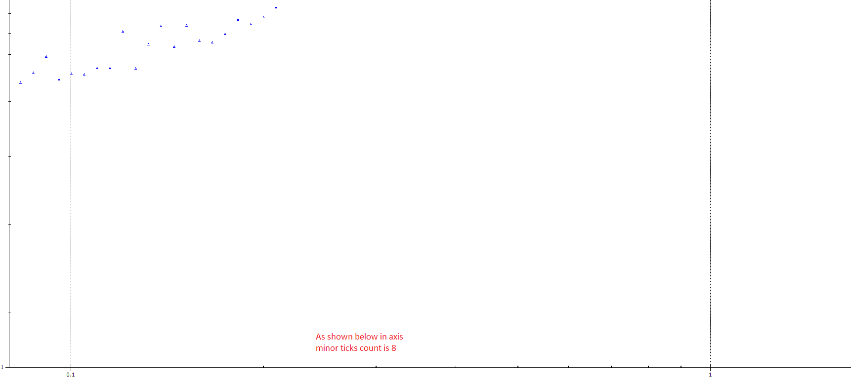

We have one issue regarding minor ticks of axis.As shown in below img1 total number of minorticks count is 8 i.e. fine

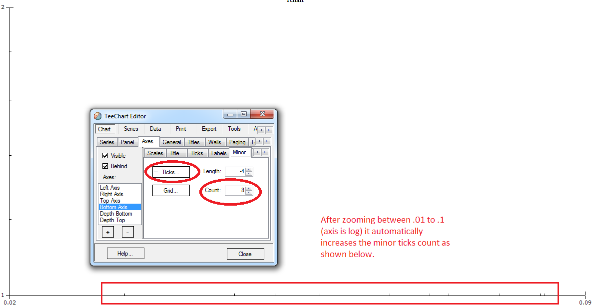

But as shown in img2 when we zoomed chart minor ticks increase 8 to 10 and the count in the editor is still 8. As shown in below img2
why minor ticks increases?

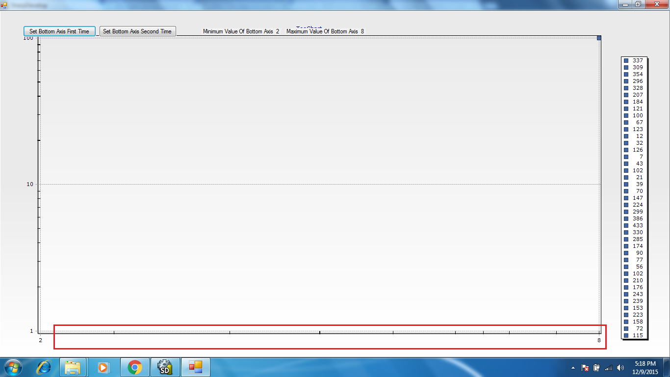

In the demo when we click on "Set Bottom Axis First Time" button then its set the Min/Max of Bottom axis as shown in Img1 below. i.e 2 to 8 here as shown in img1 the highlighted area MinorTicks Count is more then expected(we had set it to 8 count).

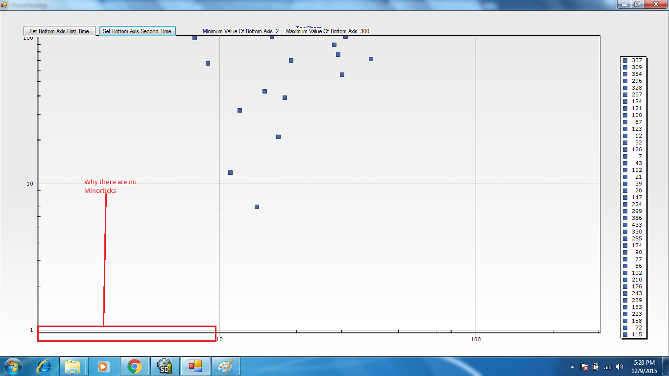

Again when we click on "Set Bottom Axis Second Time" button then its sets the new Min/Max of Bottom axis as shown in Img2 below. i.e. 2 to 300 as shown in this img2 highlighted area does not shows any Minorticks.

This seems to be a defect which I have added to our issue tracker with id=1387. Other than manually drawing the ticks yourself using the OnAfterDraw event, I'm afraid I cannot think of any other workaround.amol wrote: as shown in this img2 highlighted area does not shows any Minorticks.
As described above we want that if we set Minorticks count to 8 then it must show 8 minor ticks.
