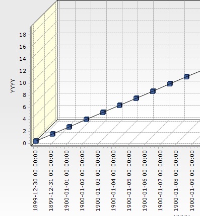

show datetime on the x-axis
Hello, When i want to show a datetime object on the x-axis
date starts at 1899-12-30
1
100%
time aways 00:00:00
0
No votes
Total votes: 1

Post by Chinfot » Tue Sep 29, 2015 7:31 am
   public class NumberAxis
            public DateTime X  { get; set; }
            public int Y { get; set; }
            public int Z { get; set; }
            List<NumberAxis> stemp = new List<NumberAxis>();
            for (int t = 0; t < 20; t++)
                DateTime dt = DateTime.Parse("2015-02-14 12:02:06");
                NumberAxis ss = new NumberAxis() { X = dt.AddDays(t), Y = t, Z = t };
                stemp.Add(ss);
            tChart1.Axes.Bottom.Labels.ExactDateTime = true;
            tChart1.Axes.Bottom.Labels.DateTimeFormat = "yyyy-MM-dd HH:mm:ss";
            points3D1.DataSource = stemp;
            points3D1.XValues.DataMember = "X";
            points3D1.XValues.DataMember = "Y";
            points3D1.ZValues.DataMember = "Z";

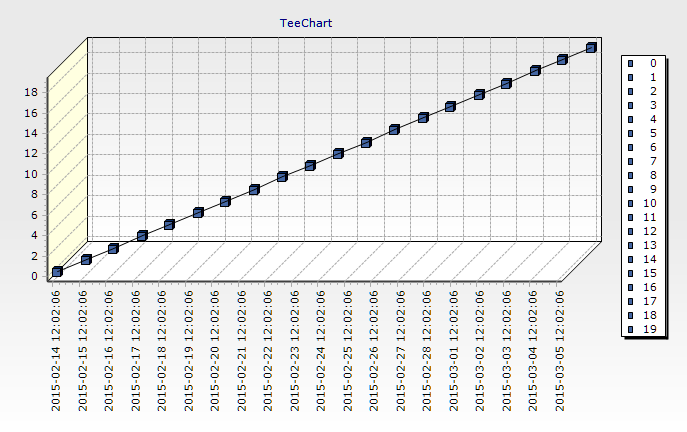

The following code:
    Points3D points3D1;
      points3D1 = new Points3D(tChart1.Chart);
        stemp.Add(ss);
      tChart1.Axes.Bottom.Labels.Style = AxisLabelStyle.PointValue;
      points3D1.YValues.DataMember = "Y";
gives me the following chart:
