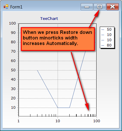

Hi Steema Support
I have one query regarding thickness of minorticks.
As shown in attached demo when we resize the form using Maximize/Minimize button or restore down button of form then few minorticks width increases automatically.
As shown in below image.

Re: Minor ticks are different in size
Post by Christopher » Tue Sep 29, 2015 8:12 am
amol wrote: As shown in attached demo when we resize the form using Maximize/Minimize button or restore down button of form then few minorticks width increases automatically.
Thank you, we have been able to reproduce this issue here and have added to our issue tracking software with id=1324.
