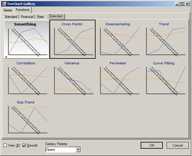

For example, as shown in below screenshots user needs to develop a new custom function by using following formula at design time.
New Custom Function= (Smoothing + Trend) / Exp. Trend
It would be great if you can add another tab as "Custom Functions" and let user to build his own custom functions by using some means such as formula builder. It will going to be a ultimate feature of your TeeChart Control.
TeeChart Functions
custom functions.png (49.43 KiB) Viewed 15031 times

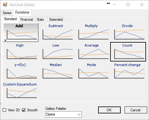

notice the RegisterFunction - this registers the function with the Chart Editor, which when opened now looks like:

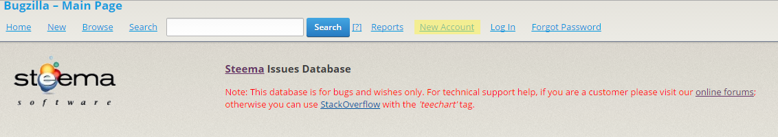

Re: Creation of Custom Functions
Post by Christopher » Wed Sep 30, 2015 12:22 pm
Quant wrote:Hi,
We don't have login credentials for http://bugs.teechart.net/. Can we use our customer/license number? Please provide some help on this.
Of course. Please click on the "New Account" link as seen here:
and then follow the given instructions.
