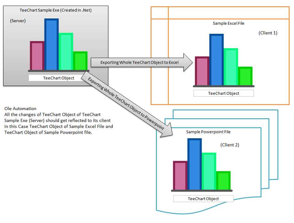

Post by Quant » Tue Aug 04, 2015 9:17 am
The above code tutorial shows connecting a TeeChart control to ADO.NET databases at design-time and at run-time. But our requirement is different. We need OLE Automation with TeeChart Control which is explained diagrammatically in following image.
TeeChart OLE Automation Concept
TeeChart OLE.png (54.83 KiB) Viewed 12779 times
Do revert for any clarification.

Post by Narcís » Tue Aug 04, 2015 9:32 am
Hi Quant,
I'm afraid this is not possible. We discussed that here and hasn't been any change since.

Post by Quant » Tue Aug 04, 2015 10:01 am
What are the other ways we can achieve the same? Since we need to finish this requirement asap.

Post by Narcís » Tue Aug 04, 2015 10:48 am
Hello Quant,
The only option I can think of is using TeeChart Pro ActiveX, it uses COM controls that can be used in Excel, PowerPoint, Word, etc. It also includes some Ole Automation examples. You can download the fully functional evaluation version at http://www.steema.com/download/ax
