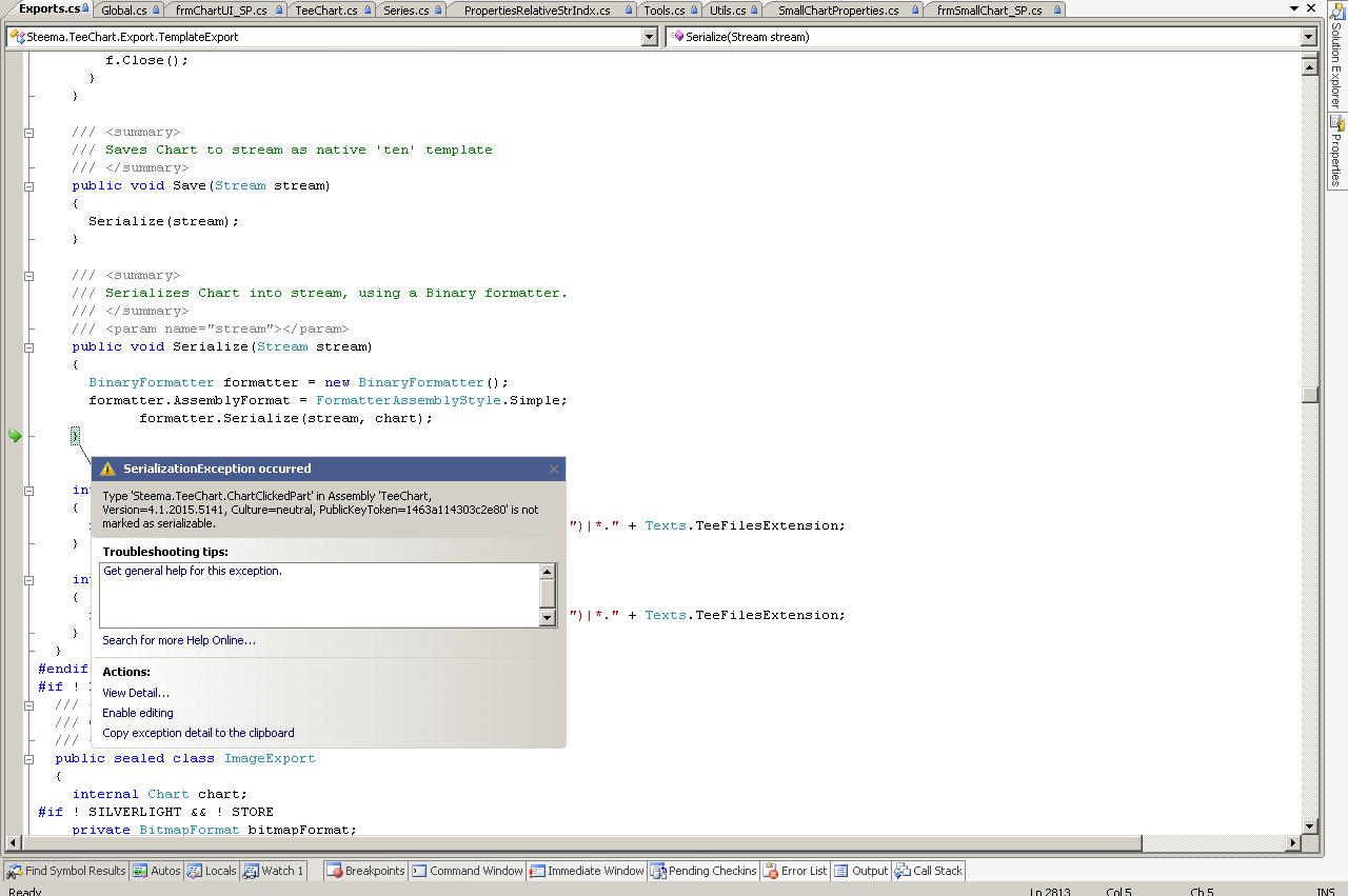

While exporting TeeChart to Native Format we are getting following error:
Export Serial.png (65.73 KiB) Viewed 9523 times

Hello Quant,
Can you please prepare a simple example project with which we can reproduce your issue here? We need to see which chart settings may be causing the exception.

This error comes when teechart contains Selector Tool.
Please find simple example project.

Quant wrote:Please find simple example project.
Thank you, that was very useful.
This defect is registered as id=1219 and has now been fixed. In the meantime, you can use a substitute derived class with the fix in it:
  public class MySelector : Selector
    public MySelector(Chart c) : base(c) { }
    [DesignerSerializationVisibility(DesignerSerializationVisibility.Hidden)]
    public new ChartClickedPart Part { get; set; }
