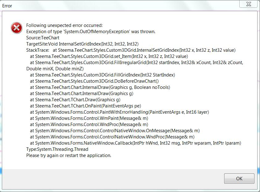

For now, I have attached error screen shot with all error details. Please have a look.
T Chart Error Info
Re: Urngent:Memory issue while surface graph plot
Post by Narcís » Tue Jan 13, 2015 12:41 pm
Hi Alias,
Thanks for the feedback. With this error message is almost impossible finding which the problem might be. According to the image I guess you are using setting the IrregularGrid property of your 3D series to true. My suggestion would be to try disabling it unless it's strictly necessary. Charts with IrregularGrid set to true are slower to calculate and therefore slower to plot.

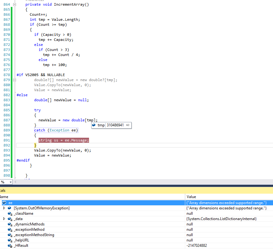

This error occurs on the first Surface series created, that is, it is reproducible with this change:
            //for (int i = 0; i < 60; i++)
            AddSuface(CreateDataTable(x, y, z), x, y, z);
In the source code, the exception is thrown here:
This error is most likely due to the fact that, by default, "Arrays greater than 2 GB in total size are not enabled" as is specified here.
Here, setting <gcAllowVeryLargeObjects> to true inhibits the throwing of this error.
