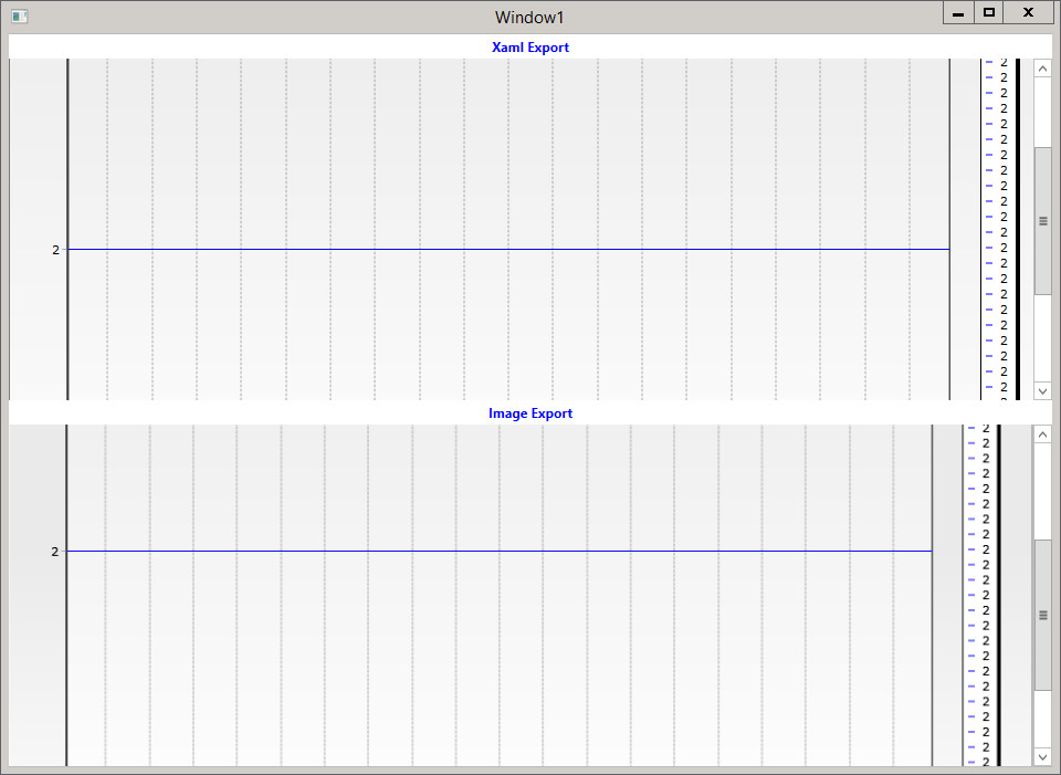

We are using TChart to show a graph in our application.
while exporting the graph to xaml when the series is a straight line or close to a straight line (moderate slope) The graph does not draw the line (appear as empty space).
Attached is a sample project, a video and some snapshots from our application that illustrate the problem.
how can we solve this issue?

I see the XamlExport.xaml ("Show run time xaml export" button) doesn't show the horizontal green lines. However, I'm not sure to see how you created the file XamlExport.xaml. We'd need to recreate the chart that seems to produce a wrong xaml when exported.
If I create a chart with an horizontal line in your application ("Draw straight Line" button) and then I export that chart to a xaml ("Show Xaml and Image" button), this looks fine for me here:

I must say that i am disappointed that this discussion is not going into the right direction despite of the fact we have made a very simple and easy to use code example that demonstrate the
problem.
Let me restate the problem and explain the test project:
1. When you run the test project we attached, you will see a tee chart graph showing "steps" shaped graph data (that works perfectly fine).
2. when pressing the "Show Xaml and Image" button on the top left corner of the screen, a new window will open showing the resulted xaml export of the same graph on the top section and the image export result on the bottom section.
3. You can clearly see that in the xaml export result the line on the "steps" shaped graph is cut in multiple places.
Our requirement:
Send us back the project where the graph xaml export works properly (you can use any version of Dll's you want).
By "xaml export that works properly" we mean: that on the "Show Xaml and Image" window that opens after clicking the "Show Xaml and Image" button the xaml export result you see at the top looks identical to the
Image export result you see on the bottom section (without any cuts or missing data on the graph).
Please sent me a response ASAP if any part of the description written above is unclear \ you have problems running the test project.
I reattached the test project just in case..

Post by Narcís » Fri Jan 09, 2015 9:19 am
Hi Alon,
Thanks for your feedback.
I build your project with the latest TeeChart for .NET release (build 4.1.2014.12150-12154) and the exported bitmap and xaml files are absolutely identical, find them attached. Can you please try compiling your project with the latest TeeChart assemblies available?
