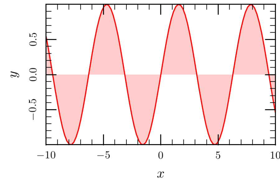

I attached a example, as image. In this image both the high and lows are filled with color. Assuming the line passing through the middle is avg. Can I just fill in the peaks (highs) ?
This is example from the web. Here both Peaks and troughs are filled. I Just want peaks filled.
I did a similar example here. This is a Delphi example. In .NET you can do something like the code below using CrossPoints function and HighLow series.
      tChart1.Legend.CheckBoxes = true;
      Line line1 = new Line(tChart1.Chart);
      Line line2 = new Line(tChart1.Chart);
      Steema.TeeChart.Functions.Average avg1 = new Steema.TeeChart.Functions.Average();
      line2.Function = avg1;
      line2.DataSource = line1;
      line1.FillSampleValues();
      tChart1.Draw();
      double avg = line2.YValues[0];
      Points points1 = new Points(tChart1.Chart);
      Steema.TeeChart.Functions.CrossPoints crossPoints1 = new Steema.TeeChart.Functions.CrossPoints();
      points1.DataSource = new object[] { line1, line2 };
      points1.Function = crossPoints1;
      HighLow highLow1 = new HighLow(tChart1.Chart);
      highLow1.HighBrush.Visible = true;
      int j = 0;
      for (int i = 0; i < line1.Count; i++)
        double y = line1.YValues[i];
        if (y > avg)
          double x = line1.XValues[i];
          highLow1.Add(x, y, avg);
          double x = points1.XValues[j];
          highLow1.Add(x, avg, avg);
          j++;
