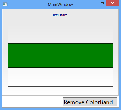

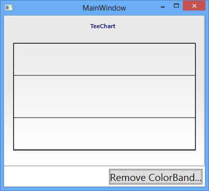

If I add ColorBand to TChart, then remove it, some dirt stays on the screen.
With ColorBand
After ColorBand removing

Hello neurosoft,
I can reproduce your problem. I have added it in bug list report with number [TW16016733]. We will try to fix it to upcoming versions of TeeChartFor.Net. On the other hand, at the moment, you can use next workaround to solve your problem:
        //TChart MyTChart;
        public MainWindow()
            MyTChart.Aspect.View3D = false;
            MyTChart.Width = 400;
            MyTChart.Height = 300;
            MyTChart.Axes.Left.SetMinMax(0, 10);
            colorBand = new ColorBand();
            MyTChart.Tools.Add(colorBand);
            colorBand.Axis = MyTChart.Axes.Left;
            colorBand.Color = Colors.Green;
            colorBand.End = 7;
            colorBand.ResizeEnd = true;
            colorBand.ResizeStart = true;
            colorBand.Start = 3;
        ColorBand colorBand;
        private void Button_Click(object sender, RoutedEventArgs e)
          colorBand.EndLine.Active = false;
          colorBand.StartLine.Active = false;
          MyTChart.Tools.Remove(colorBand);
Could you confirm us if previous code works in your end?

Thank you, workaround works for me.
But I'll also wait for updated version.
