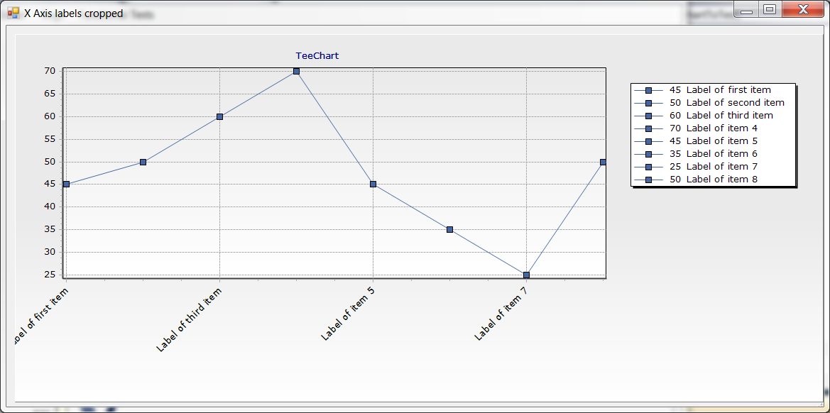

Dear,
If we have long text labels on the X Axis, the first label gets cropped when we rotate them. see screenshot attached.
What can I do to make sure that the label does not get chopped off.

The problem with this solution is that our data on the chart (including the labels) in very dynamic. We never know the length of the labels, so setting a hard coded margin is not the best solution. We are looking for a solution that takes into account the length of the labels.

You can use MaxLabelsWidth to calculate the width of your labels:
 private void CalcMargins()
      tChart1.Draw();
      tChart1.Panel.MarginUnits = Steema.TeeChart.PanelMarginUnits.Pixels;
      tChart1.Panel.MarginLeft = tChart1.Panel.MarginLeft+tChart1.Axes.Bottom.MaxLabelsWidth();
My recommendation is you use a similar code as previous to fix your problem.
